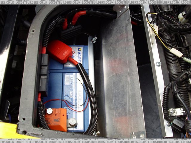

40inches
| posted on 9/3/19 at 08:32 PM |
I have a Varta B34 330ca, 4 years old now,started today with no chugging
