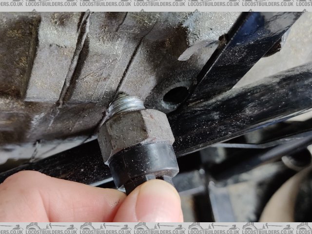

Evening All,
I have a problem with my reverse switch. As the car has not been IVAed it will need reversing lights, but the switch on the gearbox is perfectly lined up with a chassis rail. I was thinking about blanking this and having a plunger or reed style switch behind the gearstick itself. The RX8 gearbox is a 5 speed, with reverse where 6th would be. This is the best option that I can think of, I wondered if there were any alternatives or if there could be an issue with a gearstick switch?
I'm reluctant to chop up the chassis. Partly because my welding skills are currently non-existent, and partly because I think it would protrude through the tunnel panel into the passenger footwell so could be vulnerable.
Thanks in advance.
Reverse 1

posted on 27/1/22 at 07:02 PM Reply With Quote
a proximity switch on the gear lever should probably work.
but do you have to do anything with the leaver before you can select reverse. - ie lift the leaver, or push it down? you might be able to detect that movement instead of the leaver position

Partofthechaos
posted on 27/1/22 at 09:09 PM Reply With Quote
That's good to know, thank you. With that reassurance I think I will go with a blank on the 'box and see where to put a switch when I'm onto the interior and electrics.
I don't think there is a specific process to go to reverse, other than you can't go directly from 5th, you have to go via neutral.
