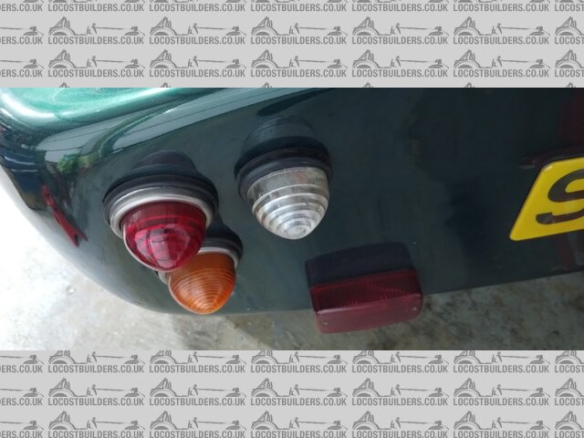

The plastic cap is inserted into the inner lip of the rubber part, and the metal ring is inserted between the inner and the outer lip of the rubber part, and holds the plastic cap in place. I had these lights on my car and they never fell off.
The model on the link nick9one1 published are slightly different from mine (bought at Car Builder Solutions (linky)) : mine are flat and flush, and need only very small holes to be drilled, just to pass screws and wires.
