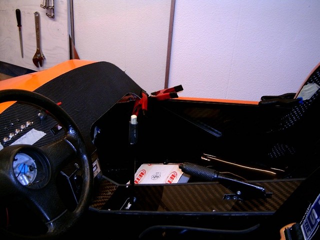

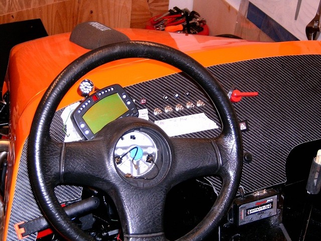

CARBON INTERIOR nearly finished
hi all
finally , almost done....
![](/galpreviews/HPIM0107z.JPG) ![INTERIOR 13-02-2005](/gallery/HPIM0107z.JPG) INTERIOR 13-02-2005
![](/galpreviews/HPIM0110z.JPG) ![INTERIOR 13-02-2005](/gallery/HPIM0110z.JPG) INTERIOR 13-02-2005
![](/galpreviews/HPIM0111z.JPG) ![INTERIOR 13-02-2005](/gallery/HPIM0111z.JPG) INTERIOR 13-02-2005
![](/galpreviews/HPIM0113z.JPG) ![INTERIOR 13-02-2005](/gallery/HPIM0113z.JPG) INTERIOR 13-02-2005

krlthms
posted on 15/2/05 at 12:18 AM |
Koen,
Very nice; a couple of ??
How are you attaching the CF panels to the chassis (screw? rivet? bonding?)
Are the floors also CF?
Are any of the CF panels structural (meaning do they add torsional strength)?
KT
bikkel
posted on 15/2/05 at 07:35 PM |
hi
side panels+ tunnelsides+rear panel =
pu- bonded +riveted
panels are much stiffer than 1mm aluminium --> a bit structural i'd say
tunnel top etc. is bolted with a few rivnuts
regards

chrisf
posted on 18/2/05 at 02:11 PM |
What thickness, weave, weight was used for the panels??
--Thanks, Chris
bikkel
posted on 18/2/05 at 07:45 PM |
i think
400 grams /m2
