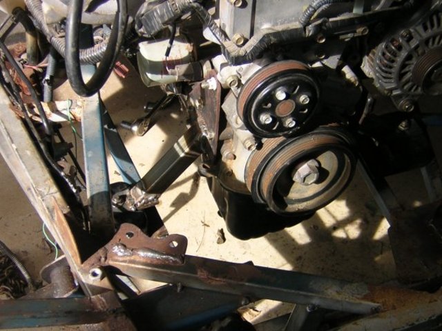

This is how i relocated an alternator on a RV8. Might give you some ideas
Fred WB

| posted on 1/8/05 at 03:38 PM |
Fed,
What is the inlet/outlet ipe on the frontof the engine?
Is it a re-positioning of the coolant in/oulet?
Looks good whatever it is
Nick

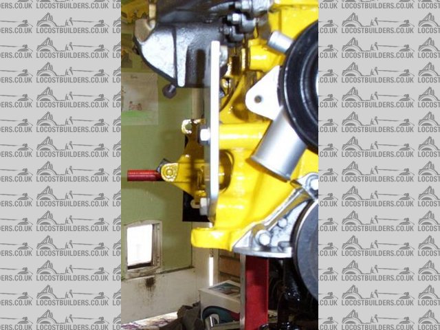

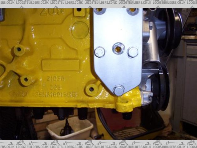

piddy
| posted on 1/8/05 at 05:36 PM |
alternator mount
Hi some pictures of my bracket,this raises the alternator well over the steering shaft.
piddy
| posted on 1/8/05 at 05:37 PM |
And another
piddy
And another
piddy
And another

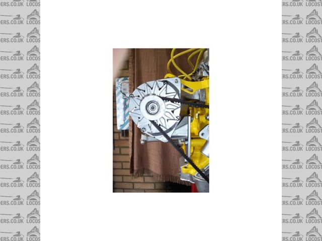

big_wasa
| posted on 1/8/05 at 06:18 PM |
this is how I did mine for the zetec.

Fred W B
| posted on 2/8/05 at 08:38 AM |
Fed,
Nick
Hi Nick
Yes, it's for coolant. I have removed the waterpump and will run a Davis Craig electric one
Fred WB

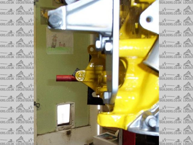

Benzine
| posted on 2/8/05 at 06:20 PM |
I recieved my pinto braket from MAC#1 today. I sent off my Bedford Rascal alternator and they made one up:
[thread hijack] Mine, however doesn't fit properly
The alternator is sitting too low and it hits the chassis (shown in pic) There are 2 reasons I can think of, either the 2 brakets welded on to the
main part are upside down and should be facing up (shown in red - I have held the alternator up where this would be and it fits) or my engine is
mounted too low (i'm just using standard MK pinto mounts though)
would work for you
[/thread hijack]
jos
| posted on 3/8/05 at 07:32 AM |
I will be very interested to see a picture with the bracket inverted as you suggest.

Benzine
| posted on 3/8/05 at 08:16 AM |
The main bracket i'm reffering to is the rectangular piece of metal. If that stayed the same, but the 2 pieces of metal that are welded onto it
were turned 180 degrees (as shown in red on second picture) then it would fit. So at the moment I can't do that unless it's rewelded
john_p_b
| posted on 3/8/05 at 08:51 AM |
BENZINE, that bracket is in effect upside down so you're right that the mountings do need changing over to point up rather than down.
it's almost identical to the one i made to mount my standard pinto alternator and that now fits inside the chassis without fouling anything.
(just!)
