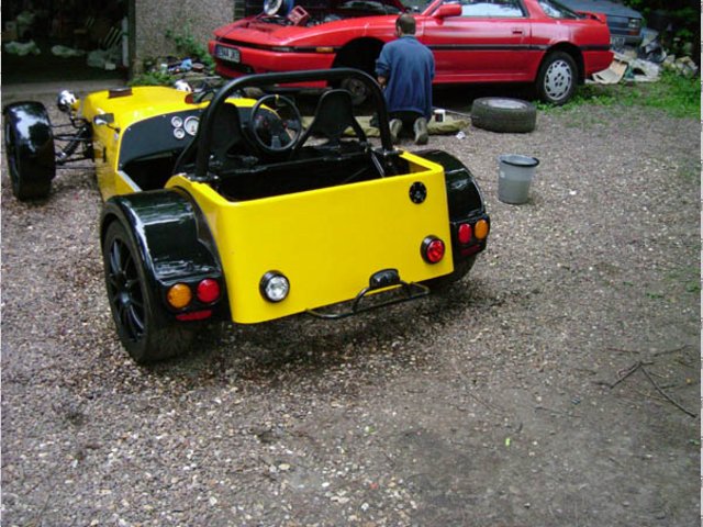

I went for these after much consideration. They will have LED bulbs in them.
Watch those LED bulbs which claim that they are 'a direct replacement' for standard bulbs. They are fine if you are directly behind the
car but a few degrees either side and they dissappear due to their narrow viewing angle! They are laso practically invisible during daylight (bent
rear end to prove it)
The new designs with 32 led's seem a little better but beware.

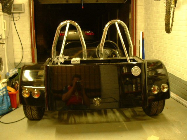

i'd be a fool if i didn't say the real SVC LED lights.
they're far and away the brightest, most visible lights on the market atm, mainly because the full area of the light is illuminated
not cheap, but far cheaper than repairing a rear ender
tom
