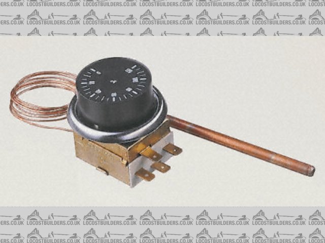

RS components sell a capillary type thermostat much like the kenlowe on for about £12.the probe can be inserted in the top or bottom hose as requred.

stephen_gusterson
posted on 3/3/03 at 10:32 PM Reply With Quote
the original switch for the fiesta mounts above the thremostat as the top hose comes in to the stat housing. I guess if you put it there it will work fine.
The RS thing, if its the one im thinking of, has a capiliary tube with a copper pencil shaped cylinder about 70mm long at the end. Its adjustable and has a copper capiliary to the adjuster.
I got one of these but decided against it cos there is the problem of getting it into the pipe without it leaking such that the whole body of the sensing bulb is in water, and the control knob is basically a skeletal switch that needs mounting in something.
Not sure of the switch rating, but it would need a relay if its not in the region of 10 amps.
I had one of these, and thougt the hassle wasnt worth it. But it is a possible solution if you want an adjustable control if you can get it fitted without crushing the capiliary under something like a jubilee clip.

david walker
posted on 4/3/03 at 09:18 PM Reply With Quote
Steve, you're probably right about the Fiesta switch in that if mounted in the thermostat housing it would probably work ok. I haven't been able to use that housing because of the (common) underbonnet clearance problem.
The switch works ok on the Fiesta/Escort but I think I'm looking for a bit of air movement at less than 90deg. These cars get very hot under the bonnet and a fan coming on earlier appeals - hence my manual over-ride.
As for the thermocouple that Paul describes, it sounds just like the Kenlowe one - but at better price. If it needs to go through a relay then OK. As for the fixing within the hose, this is exactly how Kenlowe do it - push it into hose and tighten all up with big jubilee clip!

stephen_gusterson
posted on 4/3/03 at 10:09 PM Reply With Quote
if that works thats great.............just looked to me that the pipe might get squished! obviously its ok
rs 561-460
12.49p
atb

paulf
posted on 4/3/03 at 10:22 PM Reply With Quote
Thats the exact one Steve ,I was looking at one at work today. I have a kenlowe one on my MGB and it is virtually identical, it can be mounted on a small bracket and a small piece of rubber put between the capillary and hose allows the hose and jubille clip to be secure with no leaks and no danger of crushing the capillary. The one on my MG has lasted 20 years so far with no problems.
Paul.

posted on 6/3/03 at 11:43 AM Reply With Quote
I had a kenlowe switch like that in my old TR. Worked perfectly, and being able to adjust the cut in temp is v.handy.
I didn't fit a relay, the kenlowe instructions didn't mention the need although the fan was rated at 30amps.
As Paul says above, with the kenlowe kit you get a piece of rubber, about an inch square that fits in the end of the hose under the jubilee clip. It had a grove along the centre which the sensor tube fits it to prevent it getting crushed. Blimin fiddly to fit when the hose is already a snug fit over the rad outlet without the extra thickness of the rubber. Took me a week or so to get it just right to prevent leaks, trick is to tighten the jubilee once the engine is up to temp and the hose is soft.
