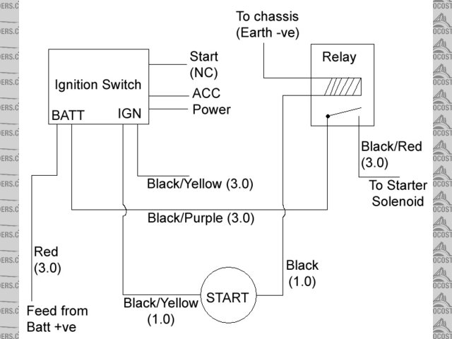

flak monkey
| posted on 13/2/06 at 04:46 PM |
Well here is my solution. For those who cant be bothered to work it out themselves. The colours on your loom may not match mine, but you get the
idea...
The numbers in brackets are the cable cross sections. START is the start button...
It should work! If anyone can see a problem with it, then shout...
[Edited on 13/2/06 by flak monkey]
