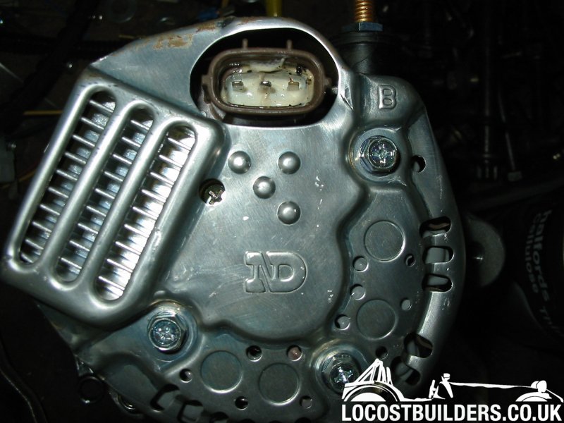

ned
posted on 10/7/06 at 09:35 PM Reply With Quote
Here's a close-up of the connector on the alternator:
http://www.locostbuilders.co.uk/upload/aIMG_2461.jpg

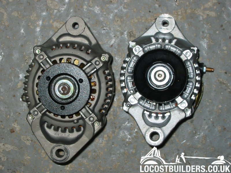

I hadn't realised how much smaller the new alternator is compared to the charade one that is broken!
http://www.locostbuilders.co.uk/upload/aIMG_2464.jpg

RazMan
posted on 10/7/06 at 10:49 PM Reply With Quote
Ned, those terminals look as if they might take the very narrow crimp-on spade connectors

silex
posted on 11/7/06 at 11:46 AM Reply With Quote
Sorry fo the delay, I only seem to get on here during my dinner these days.
Appologies for the part number, the one I gave you is for a full assembly and not shown on the website. The part number should have been 174357-2.
See the link below
174357-2
The connector is a Tyco/Amp Econoseal J Mark II+
If you look half way down the page on the left where it says " Product drawing " the link will open a engineering drawing in PDF format.
Hope that helps.

ned
posted on 11/7/06 at 04:30 PM Reply With Quote
thanks for the link silex but looking at the pdf I'm still not sure it would fit, it looks a better match in the catalogue pdf than the individual one Any idea where I can order one from? I'm also going to order some 2.8mm spades from vrp and see if they are anywhere near though I think they might be too large.
