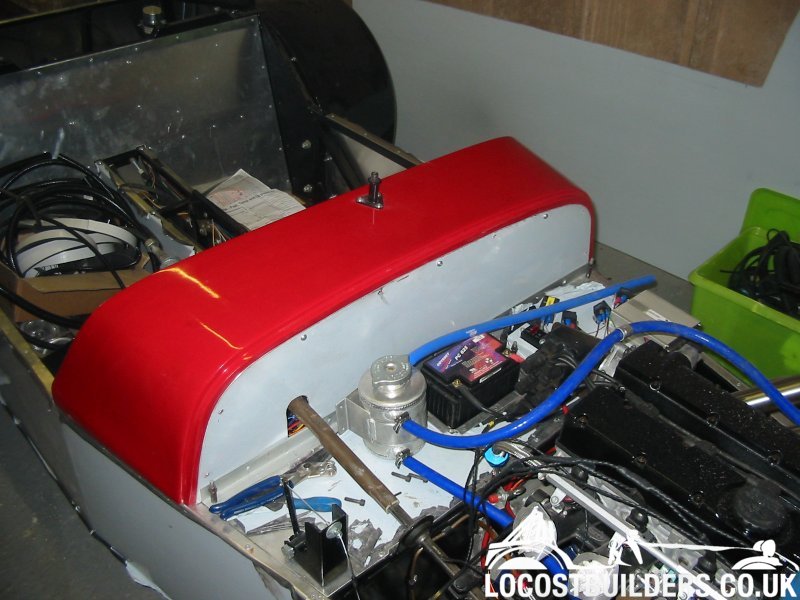

mark chandler
| posted on 13/2/07 at 09:11 PM |
Put mine in front of the engine with rectifier, short leads and as low as you can get.
[Edited on 13/2/07 by mark chandler]
