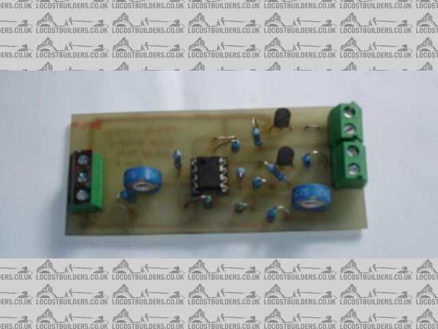

So now you are wondering how come I got it to work? I made a small circuit that did two things - scale the voltage from the sender (compensates for
different resistances) to the defender and to invert the signal (compensate for the different direction).
Simplest solution is to change the guage for a series one (whcih you can't as a separate guage does not exist - usually they were part of another
guage) or use defender sender.

02GF74
| posted on 18/4/07 at 07:12 AM |
and DIY adapter:
