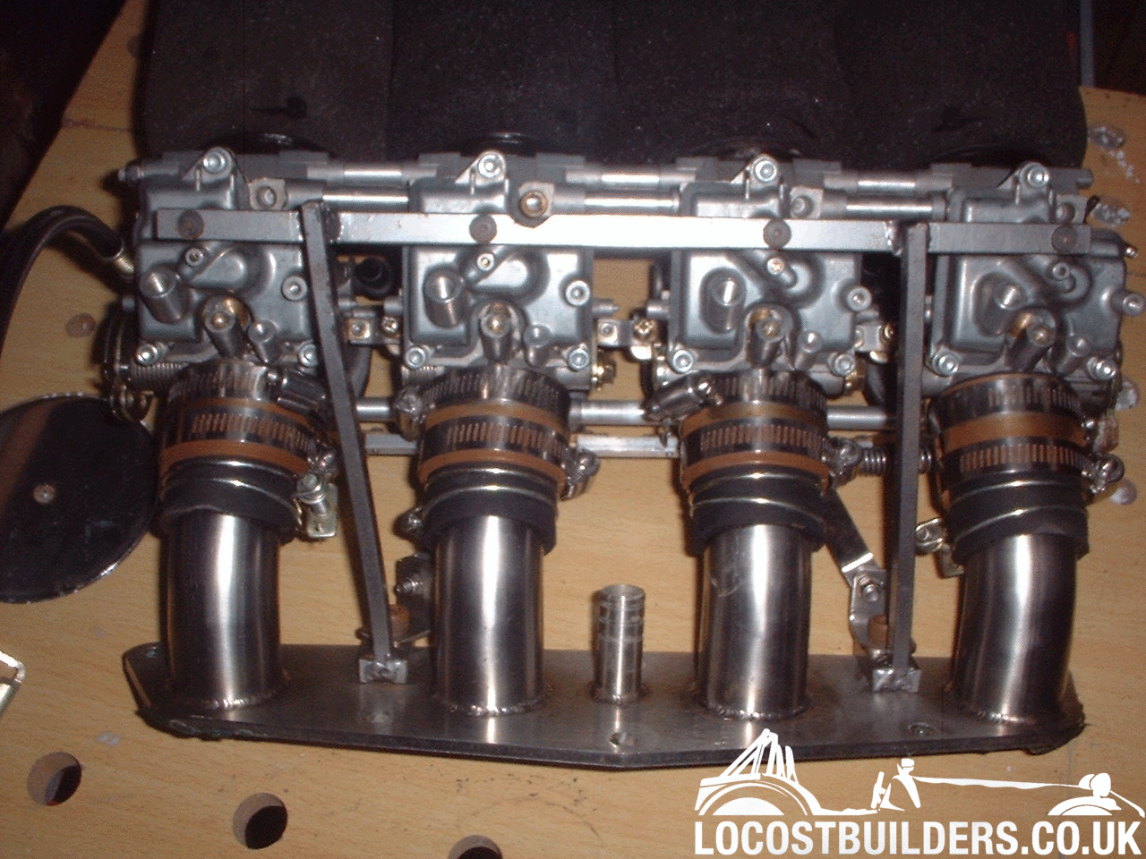

I had a similar problem but with bike carbs and no fire,but they fell of a few times.I ended up making a bracket to support there weight,so the hose just joins them to the manifold.
[img]http://www.locostbuilders.co.uk/[/img]

I used to have the same problem with mine, back when i used to have a boat anchor, i fitted some bike brake cable bolted on both ends then bolted to the rocker cover, worked well for me.
zx9 carbs ties
zx9 carbs ties
