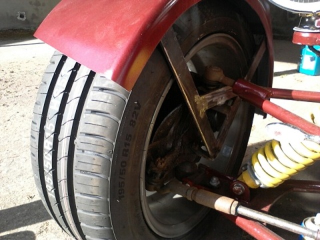

[img]
[/img]
well we had sun, rain, sun, hailstones and sun today, but got my wing stays made up and attached fixed the wings on with tiger seal and will glass
over this once dry, wasn't happy with my rad mounts so going to redo them tomorrow and hopefully some wiring
used 30 x 6 ms so hopefully shouldn't flex... too much picked up on the top and bottom ball joints and on the top caliper bolt... so we will
see.
Gary
