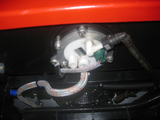

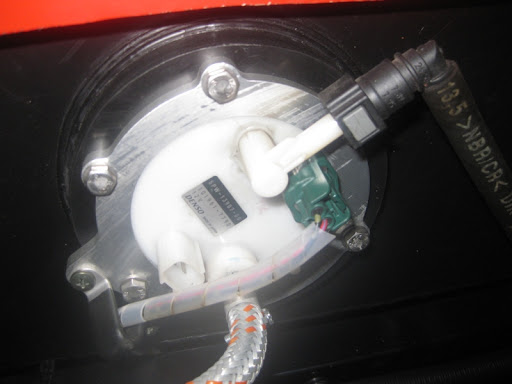

posted on 22/12/10 at 05:01 PM Reply With Quote
Just to close this one out for you
Here's a couple of pics. These are looking from the back of the car. The pump mounts externally on the underside of the fuel tank. I've got a hole that the pump goes into with a thicker mounting plate section to bolt the pump to so that the bolts don't penetrate all the way through.
The silver hose is the return feed from the engine, The black one with the Yamaha clip is the outlet. The connector is the pump 12V supply from the ECU. The unused connector is the fuel level indicator. Basically it tells you when it is low as the bike didn't have a graduated level. No point wiring it up as I'm led to believe that it goes through some electrotrckery in the bike dashboard to turn on the light.
I'll probably fit a plate on the car to protect the pump and hoses but for the time being it should be fine.
