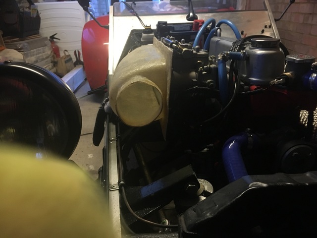

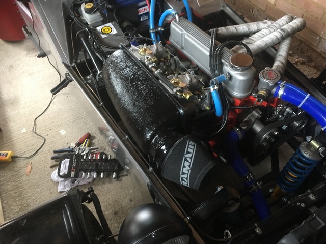

Christof
posted on 5/2/18 at 02:31 PM Reply With Quote
thought i'd hijack this thread again and show the finished article
[Edited on 5/2/18 by Christof]
