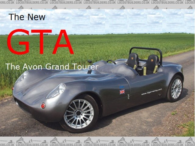

As it looks like im coming back to Europe !!! my mind is racing towards another build, I've done a 7 style body before and fancy the feeling of
a "full bodied" car, I recently stumbled upon the new body for the Tiger Avon (pics below) now I like the Avon .. But I would like to
update the running gear from the now severely aging Sierra.
So whats the contenders for a new donor ? I was thinking along the lines of re-engineering the chassis to accept running gear from a MX5 any comments
or advice ?
Im desperately trying to find my copy of how to build an avon book !!! I have one but where is the question ?
![](/galpreviews/new avon body from tiger racing.jpg) ![Description](/gallery/new avon body from tiger racing.jpg) Description
![](/galpreviews/New body for the avon from tiger racing rear.jpg) ![Description](/gallery/New body for the avon from tiger racing rear.jpg) Description
![](/galpreviews/new body from tiger racing for the avon.jpg) ![Description](/gallery/new body from tiger racing for the avon.jpg) Description

Like the look but I think I would consider the Fury.. I think it's Just a different body on top of the Avon, so the chassis is not as optimal as
it could be i.e. your wasting space in the engine bay ect..

I think they used a Fury as the donor! The bit's they have altered (around the cockpit) are a bit clumsy IMO. Underneath it looked like a
standard Avon chassis at Stoneleigh. still had the original light brackets under the bonnet.

Working just down the road from the new premises, I can confirm it is a standard Avon underneath.
There is an additional charge for extra brackets to fix in place.
Standard body is about 720 + vat (Make sure you get the new mould version)
GTA body about 1200 I think.
