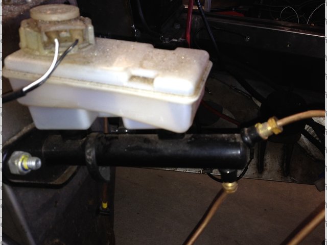

Can anyone identify the following MC please (it has no ID marks on it)? It has a Ford reservoir and looks similar to some Fiesta one's I have
seen (but none of those had an outlet at the very end).
Thanks in advance!

The plastic band round the mcyl barrel carries the identifier. Can you read off the numbers? Looks like an old Girling type, so number could be
74066***, or similar 8 figure set.

Sorry - should have said that the number on the tag is worn away.

LOL... the band had worked its way inside-out!
The code on it is: "6826-1-62/38-45 bm". Nothing coming up on Google.
I assume the 62/38 is the front / rear bias.

Bingo! A google image search showed up a pic of the same MC... from our very own forum!
THREAD
Seems it's a plain old-fashioned Sierra / P100 MC after all (not like any I've seen!).
These are the varous part no's (none of which bear any resenblence to the tag details, but hey-ho!)...
GIRLING 4006224
FORD 6186005
FORD 88BB2140BA
BOSCH 0986480608
BENDIX 132805B
DELPHI LM39027
TRW PMH224

Yes Sierra, I had one fitted but the seals failed so it went in the bin

Yes a Sierra one! I've got my old one in the garage if you need one.
Changed mine for MK1 Fiesta for more pedal feel.

My brakes were hopeless (even after a good bleed), so the MC will be the first thing to get changed!
