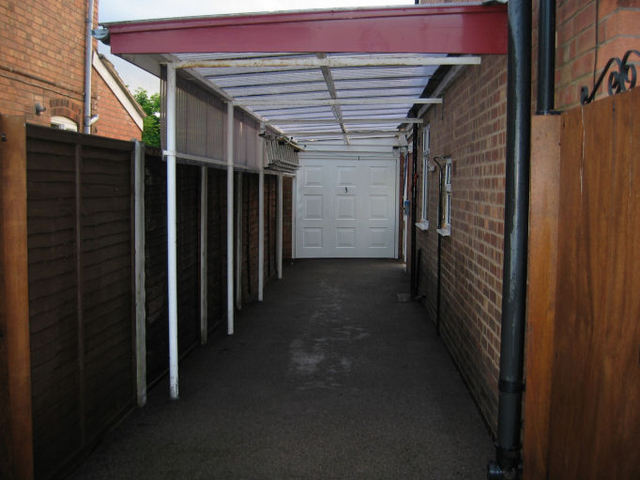

ReMan
| posted on 14/12/09 at 10:02 PM |
Just found an old pic.
polers, angloe iron, bit of wood plus corrugated plastic sheets
| posted on 14/12/09 at 10:47 PM |
