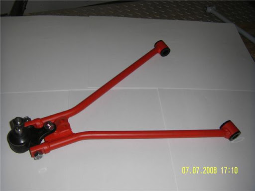

I used a moog top ball joint Ill see if i can the exact number and mx5 bottoms.
I built custom wishbones though.
![](/galpreviews/n670632270_1058875_5268.jpg) ![top bone](/gallery/n670632270_1058875_5268.jpg) top bone

Yes use the mazda bottom one but you need to find one with a thread for the top. I just went into a wholesaler of suspension parts and went through
all the joints until I found something that fitted. Pretty sure that it is from a Mazda van. Just something on the bottom wishbone above? I was under
the impression that the original ball joint bolted under the flat plate not on top like that, could be wrong as it seems most people do at as you
have, but it seems to me that it would sit nicer and be more appealing visually otherwise nice job. Especially nice job on the top.
