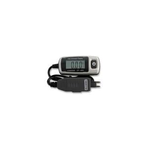

A normal DMM is not the best meter for tracing current drain as it is too easy to blow the internal 10 amp fuse. I use thiss type of Ammeter that
plug into fuse sockets they measure 10ma up to 20 amps and can survive a fairly large overload.
