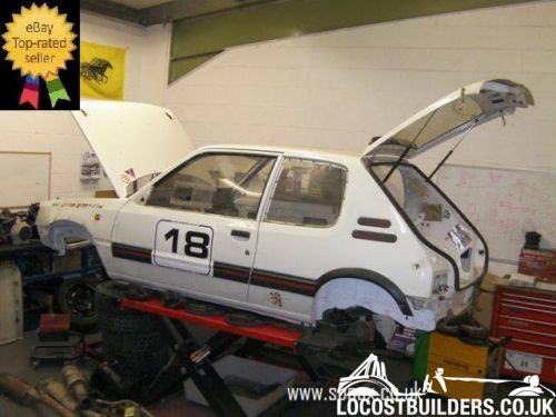

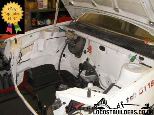

posted on 15/11/13 at 10:38 AM Reply With Quote
New shell to be rebuilt...
snakebelly
posted on 15/11/13 at 11:06 AM Reply With Quote
That's in cracking nick, good buy, if your interested I was having a clear out yesterday and found my old 205 GTi front strut brace.
