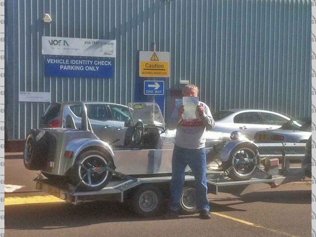

907
| posted on 6/4/17 at 11:52 AM |
I think you just massage the date of manufacture to fit in with the regs.
My trailer, be it twin axle, has wheel mudguards that will take the weight of the car so I can drive over them.
This keeps the width down to the same as the tow car, a bit narrower in my case, but still has a low centre of gravity.
Even a car with sills still fits as it's frequently used to transport a lowered MX5 to track days.
Paul G
(Pic taken IVA day)
[Edited on 6/4/17 by 907]
