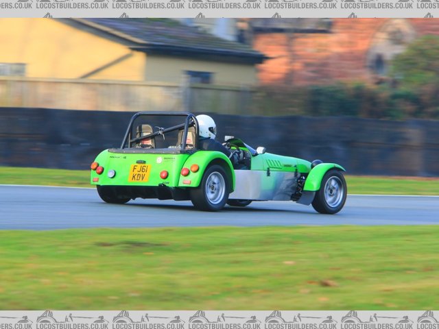

PAUL FISHER
posted on 10/5/17 at 09:59 AM Reply With Quote
No problem with a single garage, I've built, repaired, and rebuilt a few kits now in my single garage, yes a double garage would be ideal, but you can manage with a single.

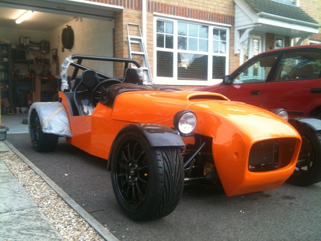

PAUL FISHER
posted on 10/5/17 at 02:03 PM Reply With Quote
Originally posted by Nathsx
Thanks Gents,
[img]http:// Rescued attachment specr 119 (Small).jpg
[/img]
Were there any points where you really struggled due to the single garage ? or is it just a case of keeping it tidier as building
Basically was it annoying or did you not really notice much ?
p.s. nice kit
[Edited on 10/5/17 by Nathsx]
Like others have said just keep the sides of the garage clear, you can always fit the bodywork on last job, pick a nice day and push it outside.
I've built 2 Indy's rebuilt a Stuart Taylor and a Westfield V8 in my single garage.
