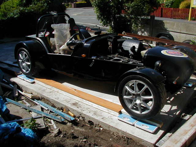

posted on 1/3/08 at 01:57 PM |
£2.99 a set from tesco
![](/galpreviews/a701700-corner weight setup.JPG) ![Rescued attachment corner weight setup.JPG](/gallery/a701700-corner weight setup.JPG) Rescued attachment corner weight setup.JPG
blueshift
posted on 1/3/08 at 08:33 PM |
Good work, that sack of sand did a pretty neat parking job there ![](/images//smilies/smile.gif)
