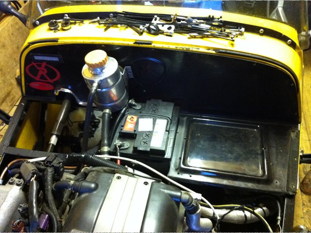

posted on 6/2/11 at 08:25 PM |
Like the battery location, nice and central and lower than the normal scuttle position too

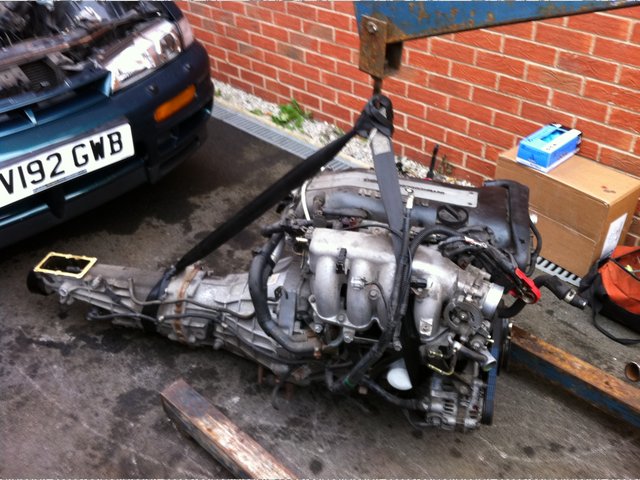

The next job was to fit the engine and gearbox with a bit of jiggery pokery it went in
engine mounts made by martin of mk engineering

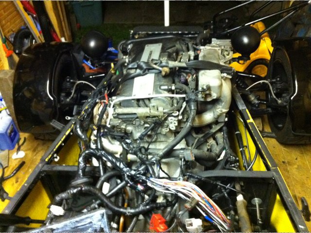

Next up came the wiring with 2 weeks on and off studying the diagrams hey presto it runs
this is the video proof

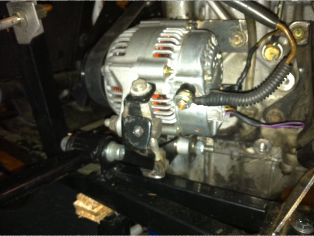

Alternator re-located to the ns

jacko
posted on 6/2/11 at 09:18 PM |
I wonder where he got that idea from only joking
Your car is looking good

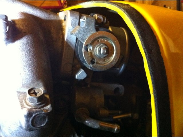

The original throttle qaudrant was too big so looked around for a smaller one and i had a spare set of bike carbs this is the end result
Ecu and wiring located in the ns under the scuttle panel

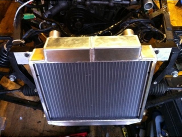

Then onto the cooling system i had a alloy rad made by martin at mk engineering

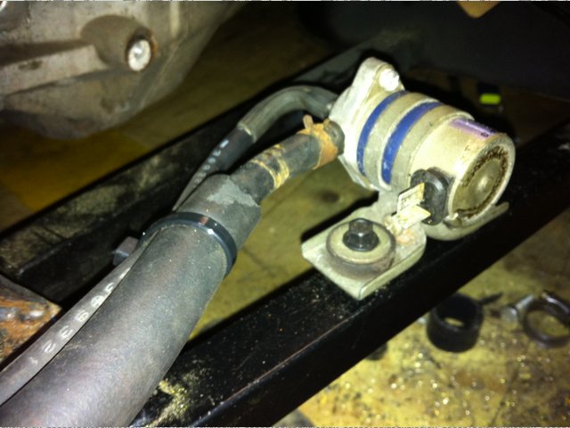

The next two jobs are where it is today and the first one is the battery re-location in between the tunnel this is something i wanted to do for a
couple of years now but never got round to it till now
just need to get a new scuttle panel

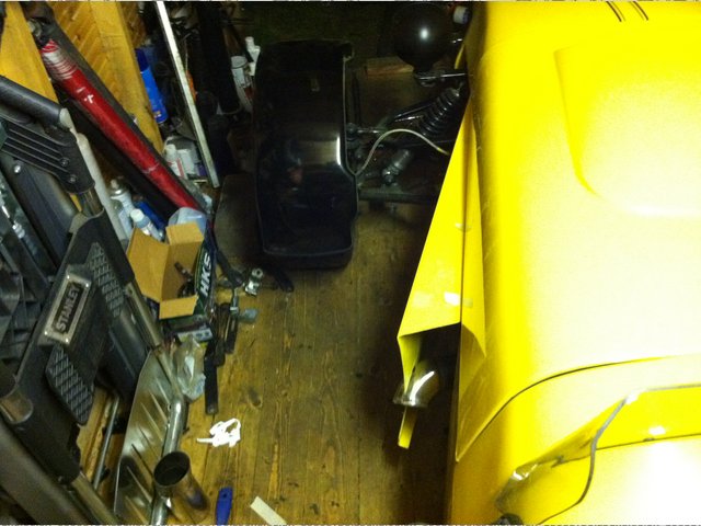

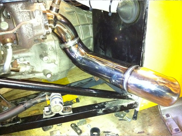

The next job is the exhaust i will not be running a silencer just to be different just needs tig welding
and no its no louder than when i ran the full exhaust system on the pinto engine before infact it seems quieter

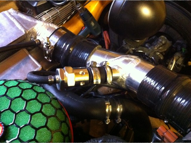

Next up is a picture of the air intake from intercooler to throttle body with dump valve pipe
And with the dump valve fitted

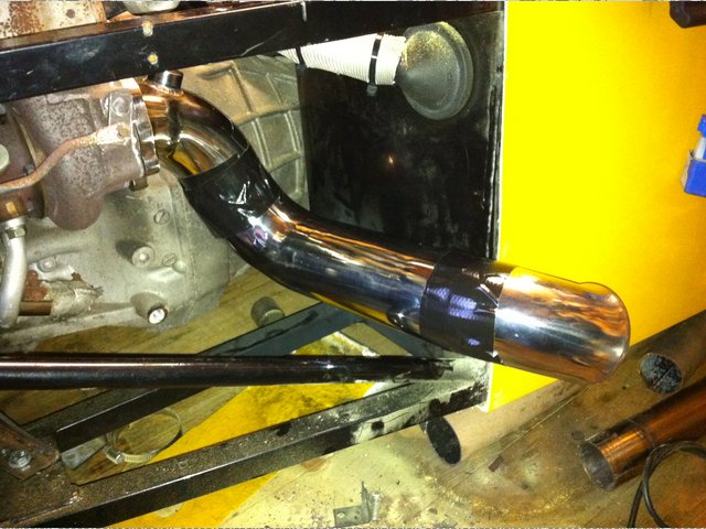

next a picture of the exhaust welded up and fitted and you can also see the electric wastegate solenoid valve

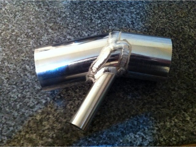

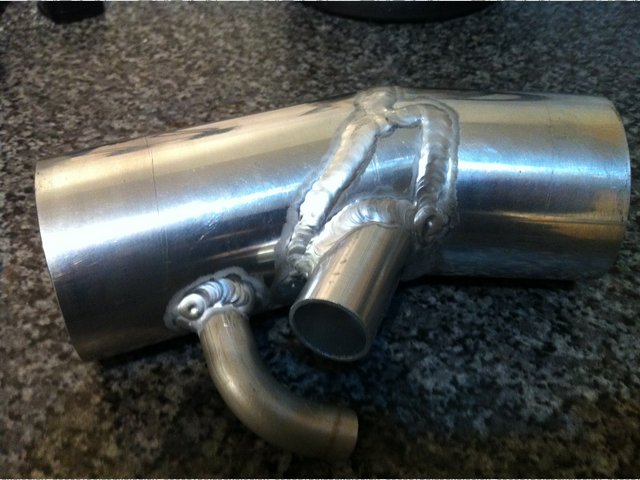

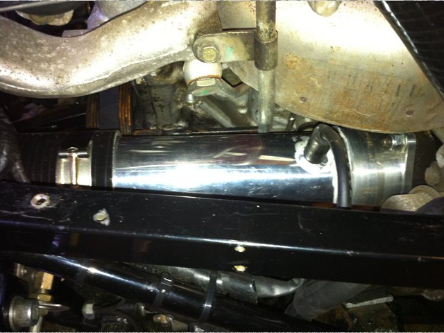

picture of intercooler to throttle body fabricated pipe but with the idle air control valve outlet welded on
thanks to martin at mk engineering

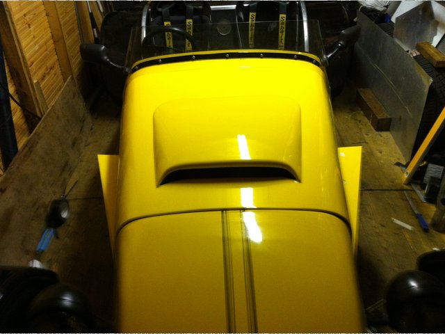

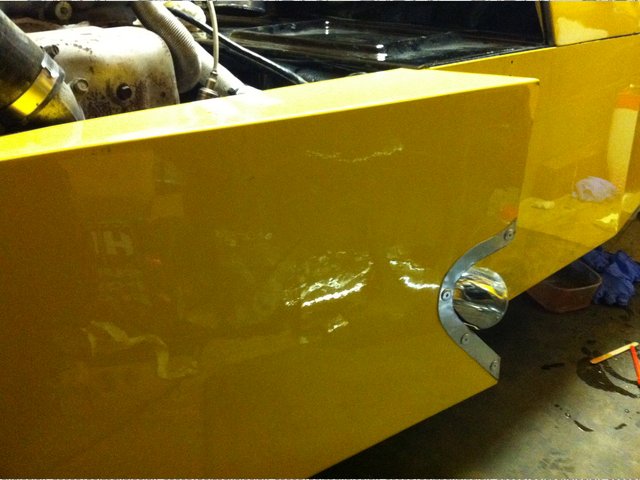

posted on 12/3/11 at 08:33 PM |
Time for a update bought some new panels,bonnet and battery tray
I am going for the wide side panel look with no exhaust silencer to keep it all clean down the sides
I will be painting the exhaust trim black soon
