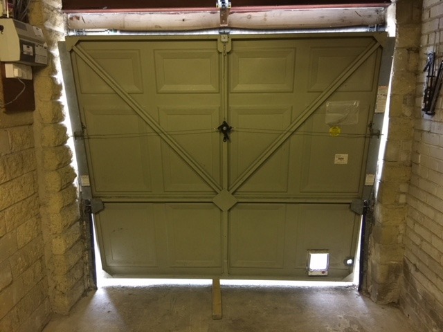

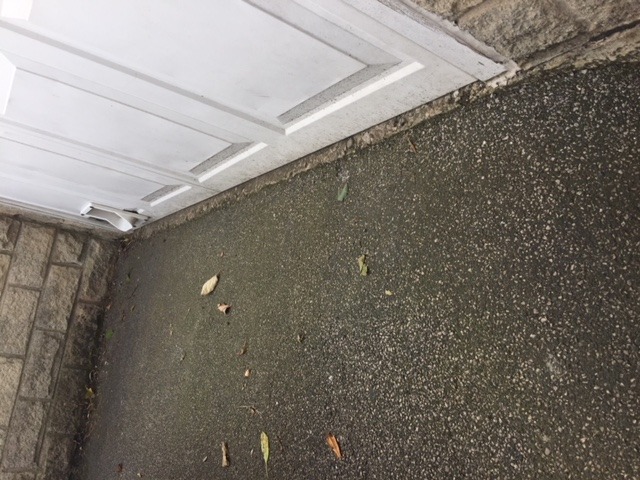

A picture speaks a thousand words fitting it internally would look even worse and loose a foot off the garage the rain water is my biggest concern.
they even fitted a cat flap the garage dosent even have access to the house

Just looked again and id only loose a couple of inch and i think that might just work guess i could paint the unsightly lintel

Looking at that photo it makes me wonder if the steel could be raised or perhaps made shallower. Probably a more expensive route overall though.
We replaced our old sectional garage door a couple of years back with a single panel Hormann up n' over door. From memory the hole was 7'
tall and 7' 6" wide. The door was made to fit the hole, but overall it wasn't killer expensive to have done. A roller door would
have been nice, but was quite a bit more money. Could be worth getting a local garage door company to quote for supply and fitting. Our fitter
removed and disposed of the old door saving me quite a bit of effort.

I’ve looked into just about every option and can’t bring myself to pay someone to do it, installing it behind the lintel is by far the easiest and
straight forward solution the door is costing me £100 delivered and virtually brand new I’ll just get one of the local lads to collect the old door to
weight in that should give my nosey neighbors something to stare at
