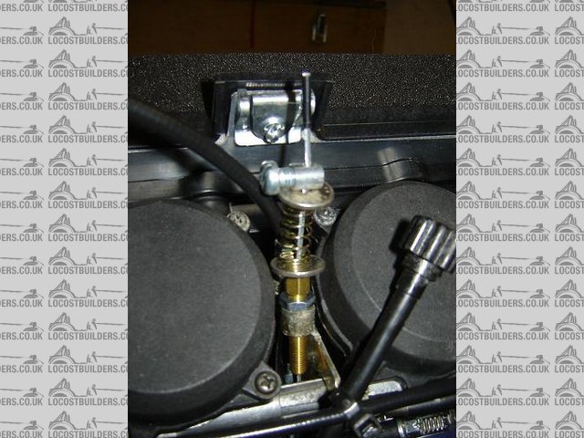

Here's how I fitted throttle return spring. Similar to Scuzzle and Rene
Short throttle cable on the return side, couple of 5p's with holes drilled in, medium spring, and a cable clamp. works a treat.
