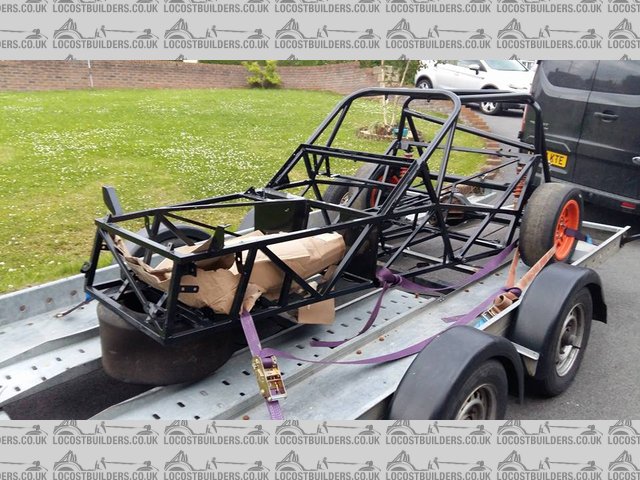

Some more progress at last! Chassis mods are now finished and the chassis is in the powder coaters
Rad mounts finished.
Prop catchers and fuel tank brackets in.
Front ARB fitted
Rad brackets and ARB
TimC has sort of set me a challenge so I'd better pull my finger out!

I'm looking forward to seeing it powder coated Tim. He's made a template for the fuel tank and welded the mounting lugs to the chassis so that should be easy enough to sort out. Hopefully we managed to get the rest of the welding sorted!
I'm probably going to get the ali panels powder coated too. The sides are new but the floor and internal panels should clean up ok hopefully before coating.

posted on 4/7/15 at 07:07 PM Reply With Quote
Powder coated :-)
Now time to rebuild it !! I've just realised I've not powder coated the floor panels yet so need to get those sorted before doing anything else really.
