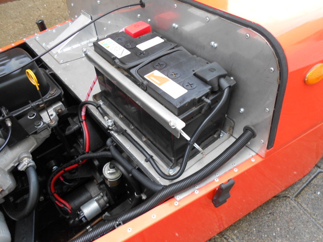

one question, (but I dont think it would be an iva issue)
are you going to rivet the top of the steering column cover to the bulkhead?
![](/galpreviews/DSCN2819.JPG) ![IVA](/gallery/DSCN2819.JPG) IVA
actually, a second point,
the battery poss lead looks like it may chaff on the bulkhead edge, (I see the spirel wrap there,) but better if its moved away from the edge

I'm not intending to rivet the steering cover as it is removable to get to the pedal box.
Good spot on the battery lead I will put some rubber edge trim on the bulkhead.

quote: Originally posted by gremlin1234
looks nice
Holy shit, that's one big ass battery!!![](/images//smilies/shocked.gif)
pstirz
posted on 2/11/13 at 08:32 PM |
Yep, its a big one (battery)
Yep it's a whopper.
It was a freebie off my mates transit. I will go smaller next time and save a bit of weight.
Paul![](/images//smilies/smile.gif)

posted on 2/11/13 at 08:35 PM |
quote: Originally posted by pstirz
Yep it's a whopper.
Paul
And half the cars weight?? ![](/images//smilies/wink.gif)

- Might want to add a p clip to secure the plastic conduit next to the battery.
- Make sure you've got a cap/cover over the live terminal on the starter/solenoid.
