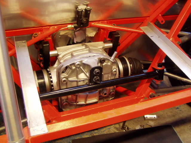

I have a 2005 round tube chassis Phoenix Fireblade. The chassis was purchased from Ian when he was winding up STM. We were lucky enough to get setup
advice from our friend Tim Gray, a man who knows a bit about the Phoenix. He suggested 250lb springs all round. The front suspension settings he gave
us won't be much use to you as we have STM fabricated uprights which were based on Capri geometry IIRC. He did tell us to leave the front alone
once set and make any handling adjustments to the rear only.
Tim had broken the rear suspension pickups on his car more than once and advised us to beef up those areas. We added cross bracing to a number of
places, in particular around the diff. Plenty of pics in my archive. Nothing has broken, so far.
