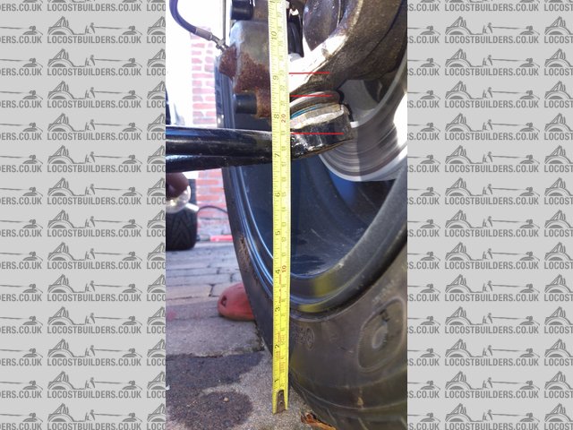

procomp
| posted on 26/10/17 at 06:28 PM |
Pivot crs are the outer ball joint centres on the upright and the wishbone bolt at chassis end centres.
The heights from the floor to the ball centres at the upright will determine what the height of the wishbone bolt centres.
If its a jp chassis you will have a sherpa lower joint and Metro top joint.
If a STM chassis it may have same joints or a few rose joints.
If it is a jp race or stm it will have the wishbone mountings on chassis raised to allow chassis to run a 80mm ride height.
If a std jp chassis it will have std chassis pick up points allowing for a rideheight of 100 - 110mm ride height unde front chassis.
For a start measure from floor to cetre of lower outer ball joint. Height. Then set rideheight so the wishbone chassis bolt centre is a same height IE
level. That then puts you chassis and rideheight into the small window of static ridehight.
Measure the length of damper bolthole centres then add 30mm to give the correct open length of damper for the application.

| posted on 27/10/17 at 04:34 PM |
Ok so I have taken some measurements!
Front Damper Length closed / open 255 - 330mm
Rear Damper Length closed / open 245 - 315mm
Between damper bolt holes max values for Droop and Bump
Front Bump-Droop 275 - 350mm
Rear Bump-Droop 280 – 390mm
So now onto this “For a start measure from floor to cetre of lower outer ball joint”
Where exactly am I taking this measurement from?
1) set at 190mm length of damper bolthole centres is 315mm if we add 30mm
open length of damper for the application = 345mm so my dampers are 15mm short
(but form a quick googling dampers come in 13” or 14” 330mm or 356mm)
2) set at 215mm then it ~345mm + 30mm = 370mm which is beyond my max droop….
Also on the rear does the same apply eg set front add rake 12-19mm then measure damper bolthole centres add 30mm?
(this measured at ~340mm + 30 = 370 rear shocks are very short.)
Sorry lots of questions much learning to do
So what is the recommendation either live with my current dampers or adapt the chassis? Or leave well alone?
