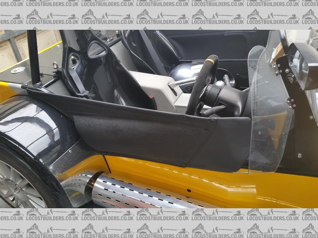

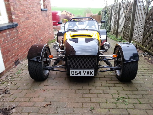

Half doors
I am not sure why I have never (OK, i might have seen one once but I could have been dreaming about that) seen a Striker with half doors but I wanted
to give it a go. Only done the drivers side for now so will have to wait until the spring to see if it cuts down on the buffeting a little
  door 1
  door 2

peter030371
| posted on 29/1/18 at 03:36 PM |
quote: Originally posted by Christof
Looks great!
Did you make those?!
p.s. is your car wearing wheel socks?!
They are standard Striker doors from RAW for a windscreen car but I cut down. I think RAW might do two types of door but these have the
'pocket' for my elbow
I have some spare wheel covers so I put them on for the winter mainly to keep Jeff W happy as he has pointed out that the tyres don't like the
cold (not that my garage has ever gone below 8°C)

peter030371
| posted on 10/4/18 at 07:57 AM |
Winter update. I have now fitted half doors to both sides and a standard RAW vinyl boot cover.
Taxed the car over the weekend and waited for the roads to dry. Eventually, yesterday afternoon, I managed to get out in her for 10-15 minutes on my
normal 'test' route and up to circa 80mph the reduction in buffeting is very noticeable in the cockpit. Very pleased with the results
Now need to do something about fitting a rear 'diffuser' to reduce rear drag (not in any attempt to pretend it will generate downforce!)
and the car is getting better with each mod
