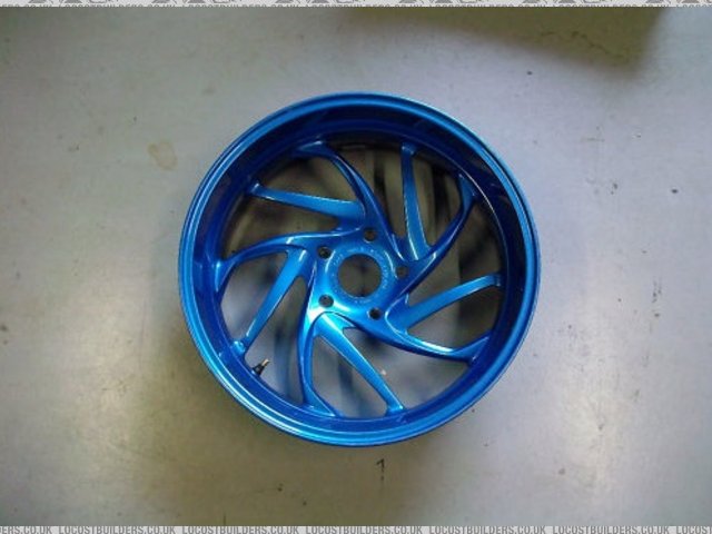

The ones on the Sub (the trike in your photo) are custom jobs.
Your best bet are BMW rears that will fit straight-up to a conventional hub. I'm using the K1200 wheel on the back of my reverse-trike until I can afford a custom one.
The only problem with fitting 3 of them is the orientation as the BMW ones are not symmetrical - the wheel design tends to flow in the direction of the bikes travel. So you'll end up with one wheels design flowing in the opposite direction to the other two (does that make sense).
The ONLY way around it with the BMW design is to to buy one 6" from a K1200 (£250-ish), and then bag 2 six-inch rears from a R1200S / HP2 Sport which has the swingarm facing in the opposite direction (so all 3 wheels flow the same way). However... the R1200S / HP2 Sport wheels will set you back £500 a pop second hand (if you can find any!).

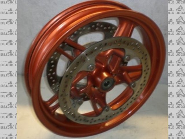

Would they be 'grippier' than a similar width bike tyre?
posted on 29/10/11 at 01:27 PM Reply With Quote
Sorry to be hijacking your thread Rowlocks... just thought it would be best to keep all the info in the one place.
I'm having a 'moment' and can't work this out for myself!!!
Could this type of wheel be run with a single brake-disc on the inside only on a spindle-hub, or would this cause wobble???

posted on 30/10/11 at 06:55 PM Reply With Quote
No wobble shouldn't be a problem. As you remove equal weight around the entire wheel there is no change in balance, hence no wobble. There will be a slight weight difference left to right, but that doesn't matter... ever had a good look at your average car wheel?
I'd be more concerned about side loading on sleek/delicate wheels like that though...
posted on 4/11/11 at 02:29 PM Reply With Quote
Cheers!
Any other opinions on this one!?
designer
posted on 4/11/11 at 03:55 PM Reply With Quote
have to agree that there will be no wobble.
But, as with mine, I am more concerned about side forces on a wheel not designed to take any.
posted on 4/11/11 at 07:04 PM Reply With Quote
Ta.
I was originally dead against using bike wheels for that same reason, but I'm getting less and less concerned about it as time goes by.
My trike should comfortably be less than 300kg, and I wouldn't imagine that I'll be pulling high lateral loads with two 120 section bike tyres on the front!
