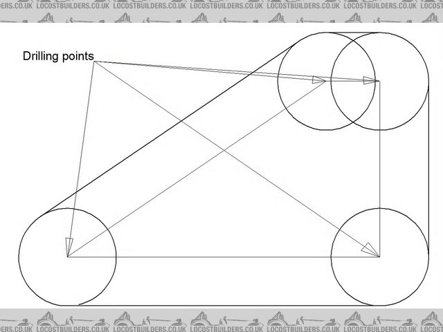

I used lots of 2" masking tape to mark out the shape on, hole saw and cordless jig saw with a fine steel blade.

Agree thick painters tape and a holesaw, if you want to make a perfectly round hole, my big question is how do you figure out where to cut. Measuring
that out can be tricky...
Take the radius of the hole you are cutting and reduce the size of the shape you want by that amount, that will give you the hole saw starting
points, then join the edges of the holes with the jig saw. Simples?
![](/galpreviews/Hole marking .jpg) ![Description](/gallery/Hole marking .jpg) Description
Ah! Do you mean cutting the hole exactly, so that whatever is poking through the bonnet is central?
[Edited on 27-9-12 by 40inches]

Yep, the tricky part is getting it central so the trumpets do not look one sided
