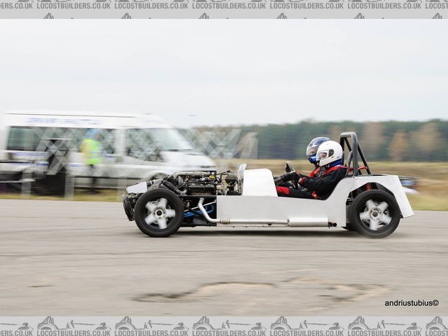

After one moth work ( race`s which encouraged work), now looks like
how handling?
in high speed very stable, if you loose back push gas and car straingh out (hard to spin out)
but in low speed, notice handling problem -under 60 kmh want understeer. have idea how remove it?
Suspension setup:
Front
TOE -0.2
Camber 1.5 degree
Caster 3 degree
Rear
Toe 0.04
Camber 1.5 degree ( with driver and passenger)
mass distribution 50/50 at full load
spring rates now checking, looking rear too soft
ackerman ok
[Edited on 5/6/17 by fregis]

| posted on 31/10/17 at 07:59 PM |
Season over
Did some suspension adjustents (most increase caster), now car fast.... to fast for me
Drive awd is fun, if you want go fast in corner you need push gas to the floor, if go in corner without gas rear go sliping - push gas and straight
out,
