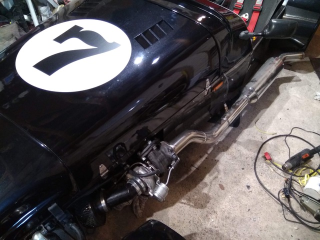

Now with added turbo.
Still plenty to do before it's back on the road.

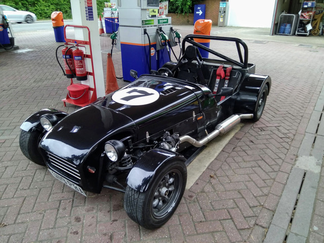

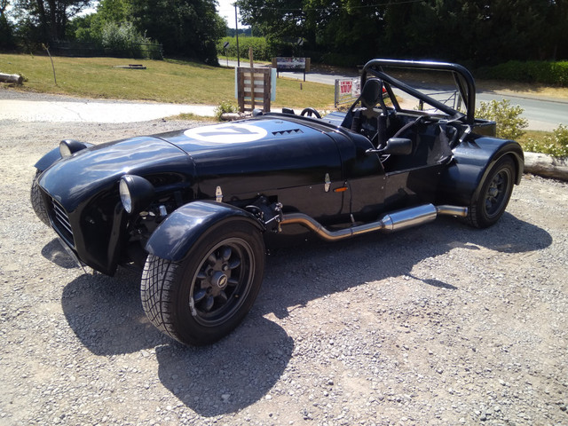

It has been almost a year since I last posted. I've been quite busy in that time. The car is back on the road, I've resprayed pearlescent black which required a lot of (endless!) bodywork.
The turbo is complete, TD04 from an impreza, RX7 intercooler. It's around 10psi at the moment, the car had a few issues on the dyno which I wasn't there to fix but mostly a boost cut limit left on in the megasquirt, I need to head back for a power run. At 10psi it should be around 200bhp. The car weighs 460kg so it shifts OK.
The turbo:

The Car (needs a clean!):

Oil return is just returned to the sump through a barb I added. I had to notch the chassis for clearance and weld up a new drain from the turbo. There is a good 20cm drop from the turbo to the barb so it drains fine.
