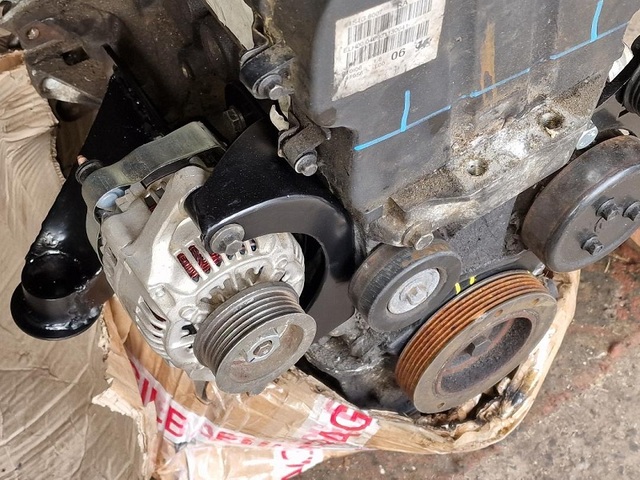

Made a new alternator bracket and opted for a small denso type alternator(bought one listed for case tractor as its cheap than a "lightweight race alternator) I know you can buy them but 1 they are £52 and 2 are for the lucas alt and I am running a small Denso unit. really pleased with how it came out spent far to much time making it look pretty and its way to enginnered made from 4mm sheet steel. ( will out last the car)

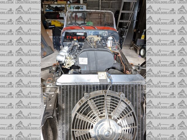

Well things are looking hopeful for the show. 10days after starting the work on the blacktop its finally in the car. not the prettiest install but time is not my friend, so after the show I will have to tidy things up a bit.
555
supersix170
posted on 4/1/23 at 08:52 PM Reply With Quote
Well she is back in one piece now and even drove out and back in to the garage under her own steam. so tomorrow weather permitting will take her out for a shake down run.

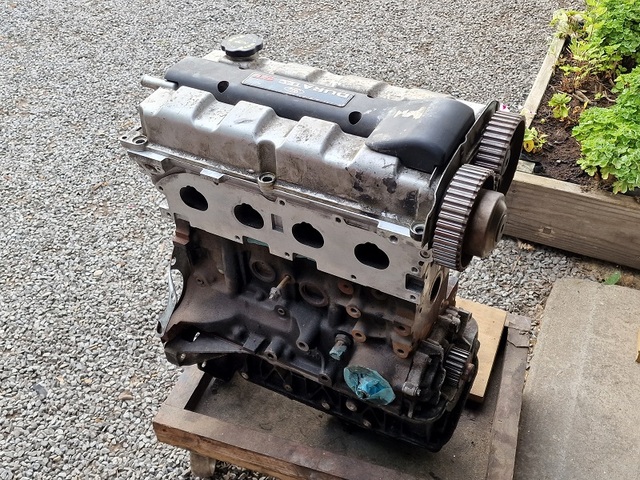

So after a bit of searching I managed to find possibly the cheapest ST170 engine in the uk, however there was 2 problems
1 been it was 340mile round trip to collect it.
2 been it was partially dismantled (are all the bits there?)
So I bit the bullet and went for it.
The old Ford Focus did me proud, as always did the trip without complaint and 78+mpg.
On the face of it the ST170 lump was in fairly complete condition the block was still assembled and not been taken apart, the head had been vapour blasted, new stem seals etc... so the head was ready to be dropped on the block.
roughly placed together to see what bits I had

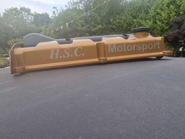

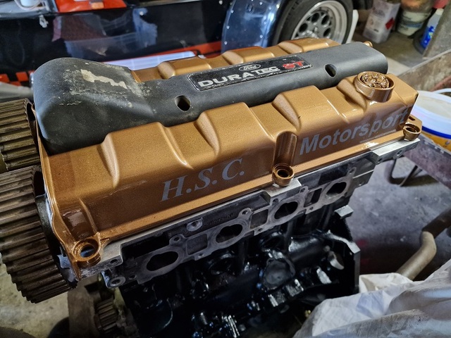

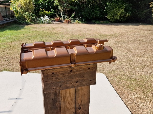

So the grand plan is to build the engine up ready for a winter upgrade/install. so the most important job for building the engine up is to ignore the checking the internals and go straight to painting the rocker cover.

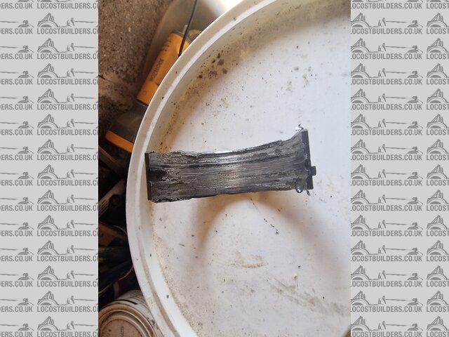

Once I dropped the sump all was not good, there was glitter in the sump!!! Number 3 main had spun a bearing and marked up the journal quite badly.

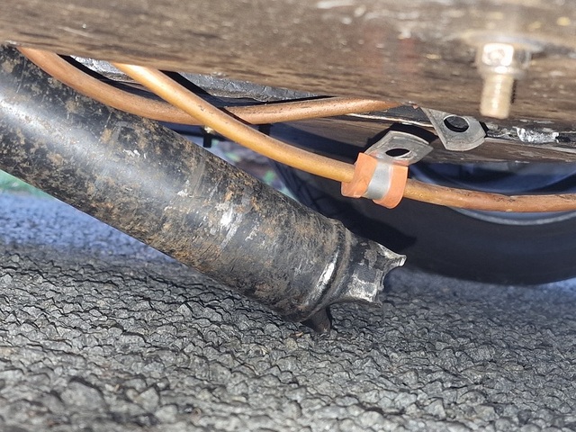

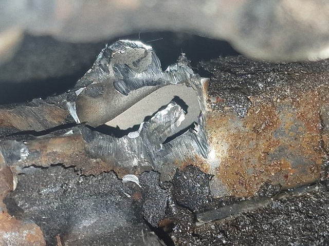

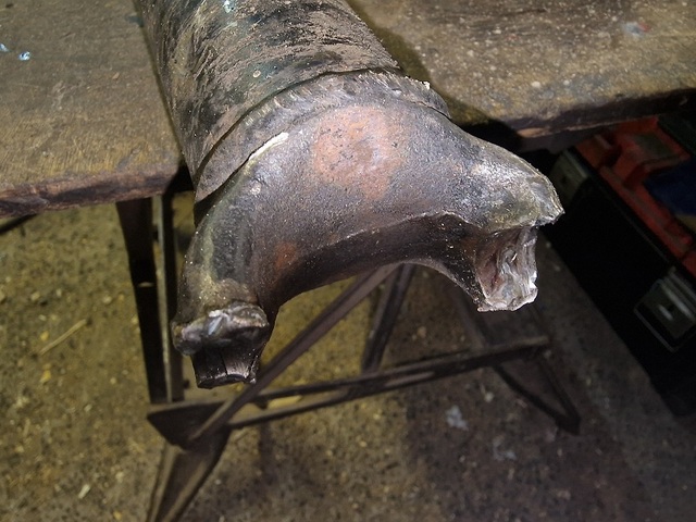

We had a bit of catastrophic failure on the way back from The Dairy Barn, driving style and generally been a knob where the reason behind it. I snapped my prop right half in two. Made a good bang damaged fuel lines took a chunk out of the chassis rail as well.

So with the car of the road awaiting a prop and the Ushaw Moor Car show only 2 weeks away, the sensible thing to do is pull the 1.8 Blacktop out and pillage it for parts to build the ST170, Seems to be a common theme for me leaving it to the last minute.
Prop was built by Drive Line I have used them a few times in the past superb service and they know what they are talking about, I got a prop made with bigger UJs so the next failure should be the axle.
