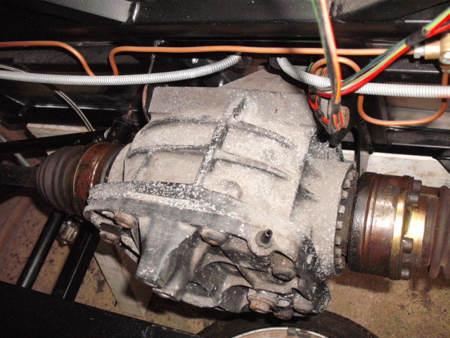

Granada Diff
As with my other post (see Rover V8 engine codes) I am trying to find out info on my ebay Luego Viento.
I have little experience for these things but I am thirsty for info so here goes:
On the back of my car is a 7 1/2 inch Granada Rear LSD Diff (or so the grumpy scot I bought it from said, he was actually a cool guy). On the diff
there is a metal tag which has the barely readable numbers AJA 364 or ADA 364, followed by 9100. Elsewhere of the diff I have seen raised letters
saying 1A K29 004-BA
What do these numbers mean and what car have they come from? I assume the diff and shafts and brake assembly came off the same car so I would like
to find out what car this was so I can buy a haynes manual for it and also the right discs and pads!!!
Anyone?

The 364 is the diff ratio, so it's a 3.64, if it's a LSD the I think it must have came from a 4X4 as they were the only ones that had the
LSD. Unless I am wrong? Not sure about the other numbers, but I think they are the part number and the manufactured date.

4x4 would have a 7" diff. If it's definately a 7.5" diff, definately an LSD, and definately from a Granada, then it almost
certainly is from a pre-bugeye 24V cossie.

Just looked it up on Google and you are correct, so I bow to superior knowledge
The ADA marking means it is a LSD though and from a Granada not a Scorpio, Scorpio's had traction control and no LSD's.
The driveshafts should be thicker than a normal Granada as well.

This link implies it def is a 7.5 inch LSD
http://www.sierraclub.co.uk/mechanical-issues-f10/diff-types-t98.html
Apparently any code with multiple A's is a limited slip and any with 2 bolts at the top is a 7.5 inch.

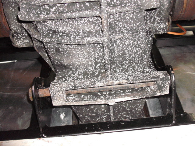

I have attached some pics to show the problem with the lower mounting, the long bolts not long enough and there is a space between the mountings. Is
a spacer (lots of correctly sized washer?) and a longer bolt all thats needed. Any ideas where such a bolt can be obtained?

Measure the disk, if it measures 273mm then it has came from a 2.9 Cosworth which they only made from 91-95 before bringing out the Scorpio.
And yeah, longer bolt and a spacer, any fastener company should have a longer bolt. Or speak to Ben at Luego, if you get really stuck let me know and
I'll get you one up here (my chum owns a fastener co)
