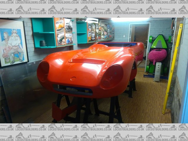

SCAR
posted on 27/11/16 at 11:02 PM |
The body fits! I was worried that 17 years left standing would have caused a lot of distortion. The only warping was the sill tops which I always
intended to cut away anyway. Once large sections of the sill top were removed the remainder could be persuaded to fit. We spent 3 hours fitting the
body then once we were convinced all was ok we removed it again. I suppose its progress of a sort
