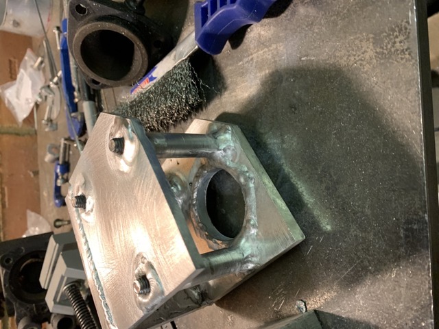

DIY Zetec thermostat housing
I managed to over tighten the gauge sender in my thermostat housing, so bought what I thought was a straight replacement only to find a different size
ECU sender hole, so instead of shelling out for another housing or sender or replacement water rail I decided to dig out the welder!!
On that not anyone know the ID of the bypass/heater output on a retroford water rail?
I think I'll have to bleed it by loosening one of the senders.

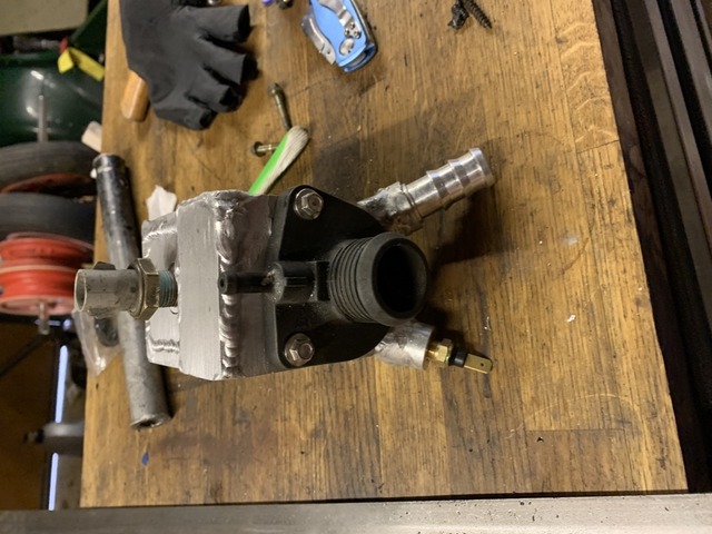

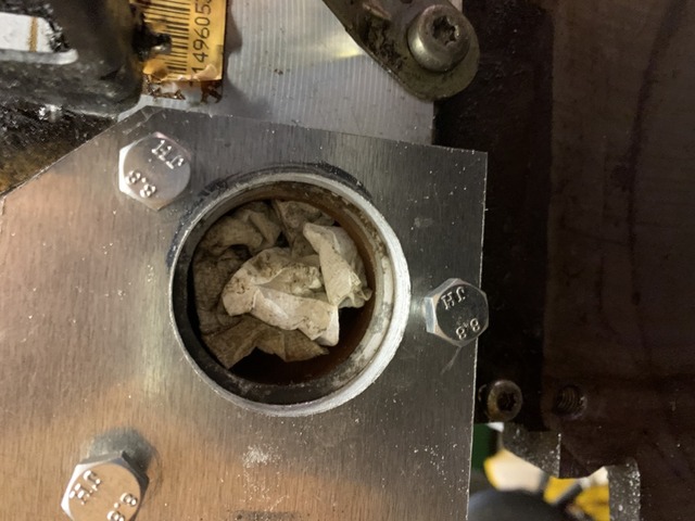

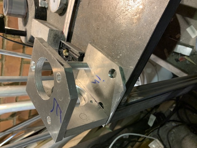

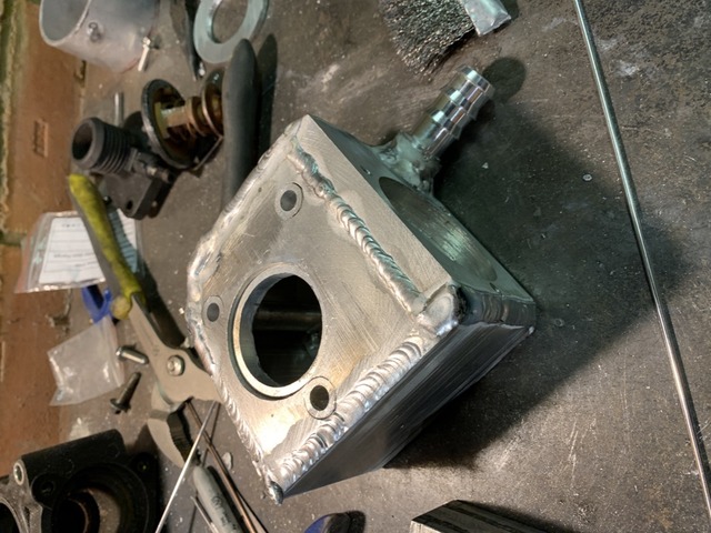

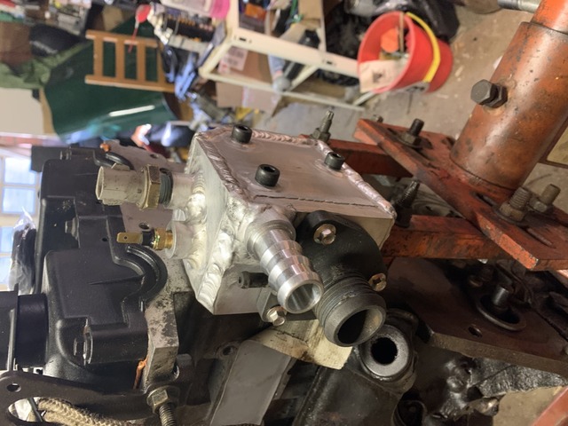

A few pics of it so far, excuse my wonderful welding, not pretty but should be strong!

Robbaa
posted on 25/3/20 at 10:06 AM |
you absolute maniac
that said when mine went tits up i had to buy a legit replacement from ford itself costing £120 (all the cheaper ebay ones were weird and blanked out
for the sender)

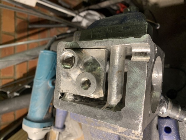

ChrisL
posted on 29/3/20 at 07:43 AM |

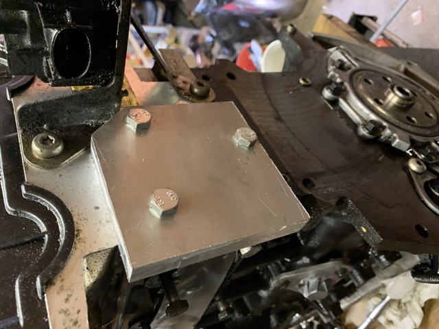

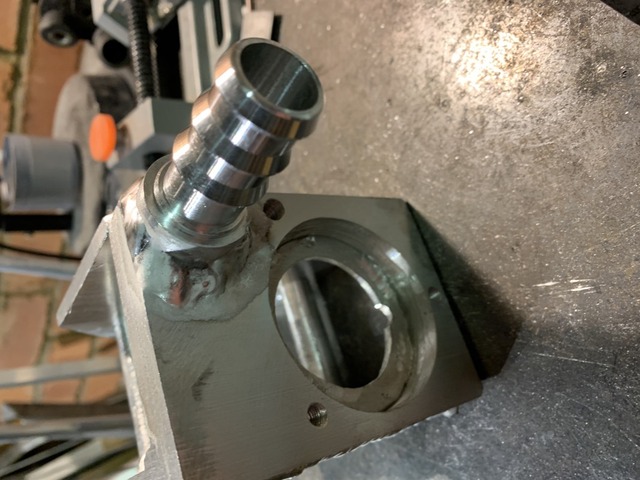

A few modifications to clear the coil pack and try to reduce the likelihood of air pockets
Cutting:
![](/galpreviews/IMG_6331.JPG) ![Description](/gallery/IMG_6331.JPG) Description
All done
![](/galpreviews/mcnsbjhgdhIMG_7715.JPG) ![Description](/gallery/mcnsbjhgdhIMG_7715.JPG) Description

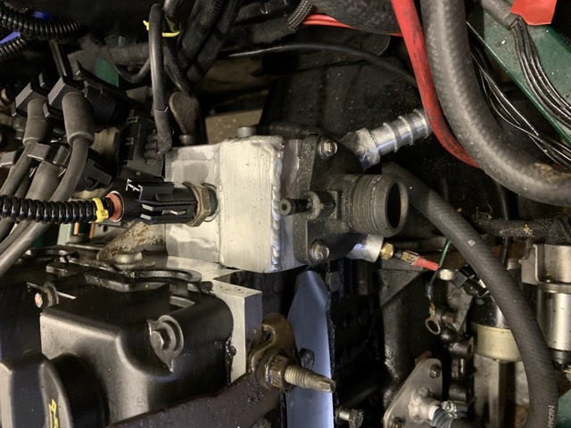

Fitted
![](/galpreviews/2IMG_8234.JPG) ![Description](/gallery/2IMG_8234.JPG) Description
Of course the proof of the pudding ... and all that!!
big_wasa
posted on 29/3/20 at 07:34 PM |
Does the stat still control the bypass ? I can’t see any passages
ChrisL
posted on 30/3/20 at 06:52 AM |
I've taken the same approach as RetroFord and limited the size of the bypass outlet. I've gone with 8mm as that's what it looks like
RetroFord have used but it's still a guesstimate. The issue with the bypass is the routing as the control mechanism means that the bypass outlet
would be on the wrong side, on the standard stat housing the outlet is routed underneath the housing to be on the side it is. I guess if I it looks
like I'm not getting enough cooling (i.e. too much bypass) I can always add it and route a 199mm pipe through and call it the MKII :-)
