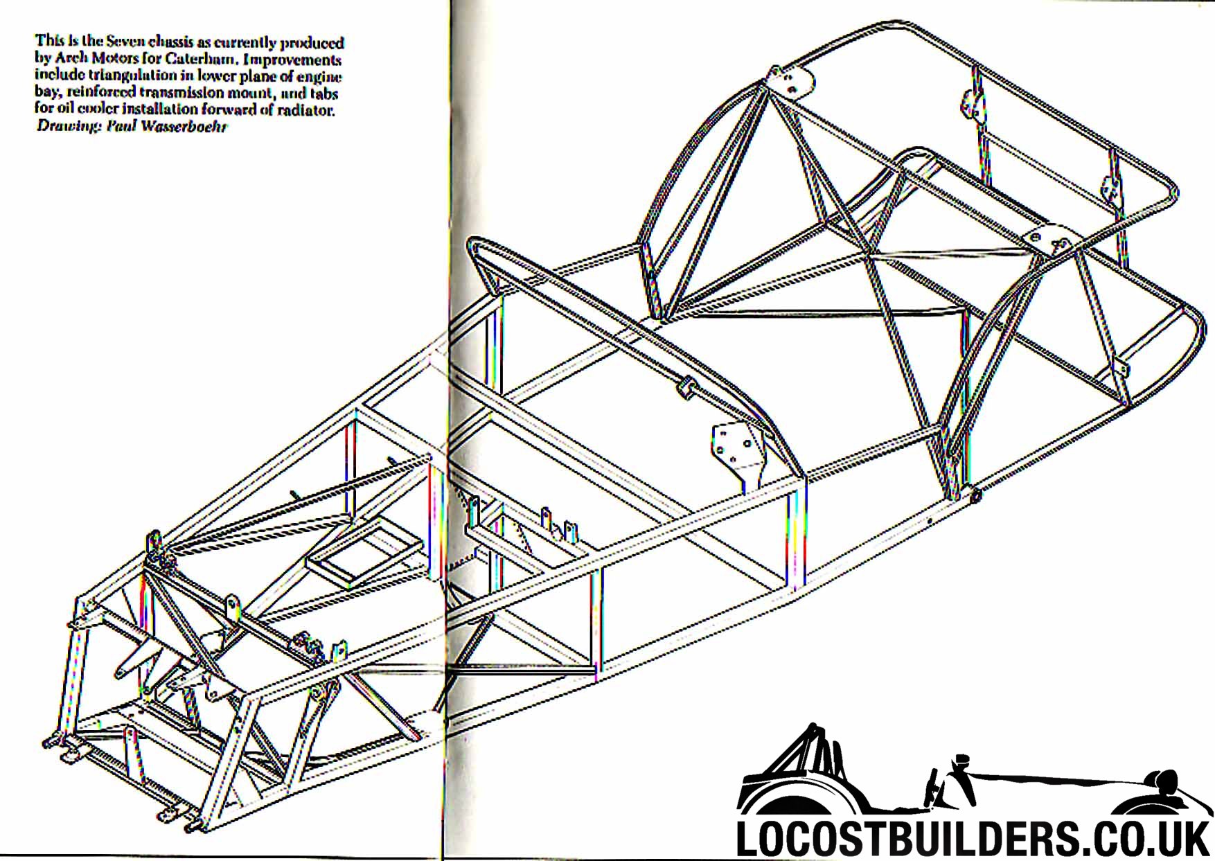

http://www.locostbuilders.co.uk/upload/archmotors%20catervan%20chassis.jpg
[Edited on 26-5-07 by mangogrooveworkshop]
Caterhams are smaller and use a lot more round tube (nearly all of it) and a lot of the triangulation that is now being done by some of the

Look into my Photo archive.
There are some details about the caterham frames.
