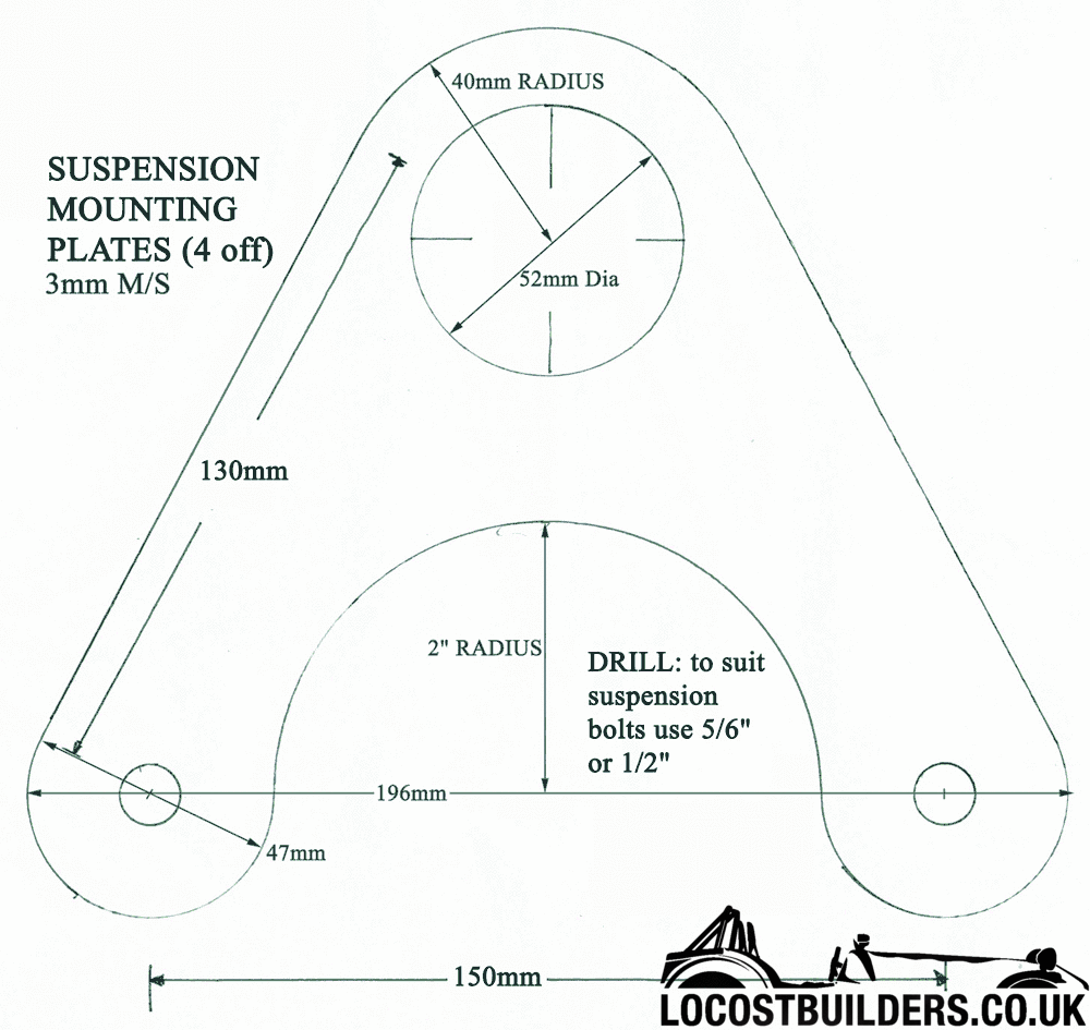

So has anybody got some drawings of the DD bracket. Something I can give to an engineering shop and they can make it for me.
I have red the treat on the manufacturing of a DD bracket some time ago, but it stopped after everybody critisised the 12 mm boiler plate flanges.
Ben_Copeland
posted on 11/10/05 at 05:53 AM |
Something Like that
Its a bit big so follow the link to it :
http://www.locostbuilders.co.uk/upload/suspension%20mounting.gif
I have no idea who it belongs to, but you get the rough idea
