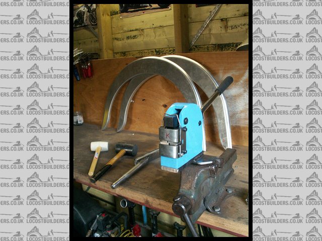

Till now I only used those rubber hammers (don’t know the English word) from the home & garden stores. Got this tip ones from a profession
bodyworker. Those rubber hammers are easy and cheap to get. And do not leave marks behind or stretch the aluminium to much, like metal or hard plastic
ones do. The slap hammer is easily to make yourself. Don't wasted your money on that.

The Shrink & stretch machine arrived and made two side panels for the mudguards today. Not as difficult as I thought it would be.

t.j.
| posted on 9/9/09 at 06:41 AM |
Did you made those two in the rear with that blue thing in the front
Maybe you can better move to my village so you can learn me that...
Good work!

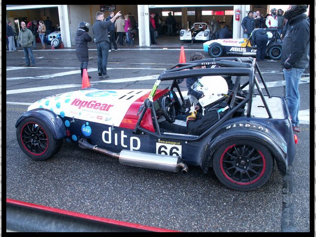

Did have a great day at the Zandvoort race circuit here in the Netherlands yesterday. I had been invited for a sponsor day of the Westfield racing
team. Nice weather, nice cars (westfield, catervans, porsche, etc)and a lot of fun. Did some couple of rounds in the Westfield as a passenger,
unfortunately could not drive myself. Some pictures:
