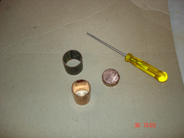

ok clever peeps, what is this then?
look (small screwdriver is there for scale)

assemble and solder it together; add 1 seoul emitter connected to driver circuit and we have this ....

I made a disc from split copper pipe and made cuts so I could fold down the sides to make something
like a bottle cap (that is the thing with the 4 holes in the first photo). This acts as the heatsink
the sides contacing the tube for better heat transfer.
