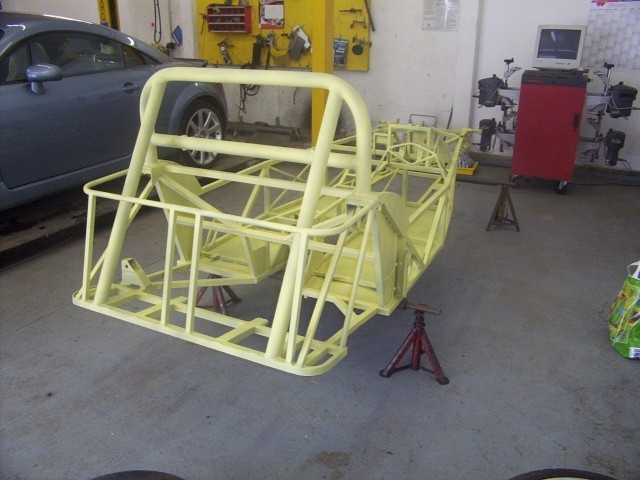

mangogrooveworkshop
posted on 30/3/04 at 06:22 PM |
Got it done for 200 Blasted etched and painted with a 2 pac see photo archive
