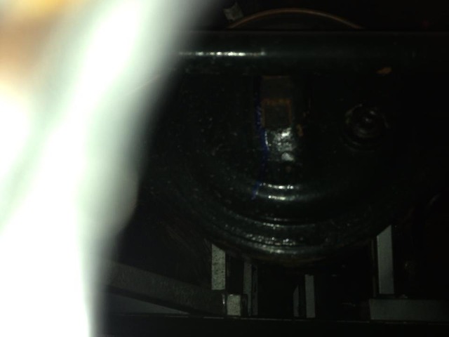

mk or not
right been talking to a person about a kit car they have for sale and they told me it an mk so what do u lot think.

Looks like early MK wishbones on the front, whats the axle set up IRS like Indy or de-dion or escort like some earlier MK engineering Locosts.

Isnt that a Stuart Taylor/Aries Bonnet with the side vents moulded in.

It does look like a Stuart taylor bonnet, which makes me think its an MK Engineering locostas the fibreglass would have fitted.

Defo not Mk if you ask me I would say Locost with Stuart Taylor bodywork on it

The tiny bit of the chassis you can see at the front is as my MK was, at the time MK were bending the tubes round areas like the footwells rather than
sharp corners. Another bit was the bent v shaped tube infront of the radiator under the nose cone. The body work I'd say is irrelevant as my kit
was bought initially with none, I only later bought some off them but could have got it from many suppliers. The front wishbones are exactly like mine
were.
You'd need to take some photos of the chassis to correctly identify the maker. Saying that MK were nothing special at all and there are many
just as good if not better than theirs.
From what I can see the car is an MK with different bodywork

Looks like a mk locost not a indy looking at the front wish bones the body work looks like Stuart Taylor the roll bar looks like a westfield copy

The early MK was the first design by Martin the originator of MK it will share the dimensions with the book chasis live axle probably. It will have
cortina uprights, the wishbones were a little to weak for cars with engines other than the Kent engine and had a tendancy to bend if the engine was
too heavy
