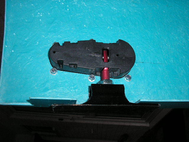

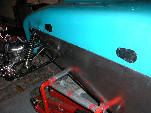

Fitted the first of the aerocatches to the bonnet today ( No Pins fitted yet so bonnet just resting )
Then made four brackets to hold the pins -Then ***ed up the brackets becasue I forgot that I had changed the drill bit last night from a 10mm to a 12mm ..
Oh well ...

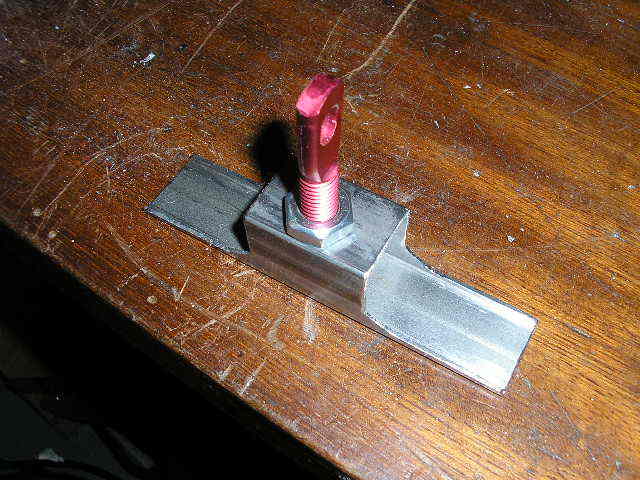

Paul (Notts)
posted on 30/10/05 at 07:04 PM Reply With Quote
Brackets
Ben_Copeland
posted on 30/10/05 at 07:10 PM Reply With Quote
Nice interior light what car did it come off
Got any closer pictures of the catches?
Ben

Paul (Notts)
posted on 30/10/05 at 07:15 PM Reply With Quote
Will post some close ups on Monday
Must be getting old as I cant see the colours on the wires without extra lighting..

Paul (Notts)
posted on 4/12/05 at 04:18 PM Reply With Quote

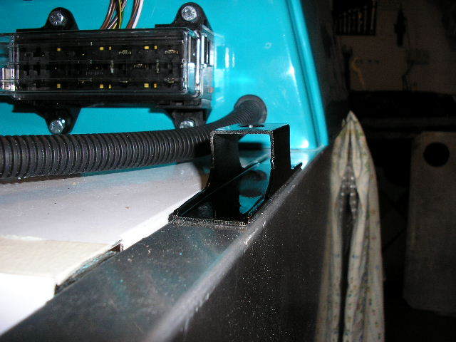

Final versions
Finall versions of brackets
* catches dont look square in photo but are in real life , must be lens on camera
[Edited on 4/12/05 by Paul (Notts)] Rescued attachment novb 019.jpg

Paul (Notts)
posted on 4/12/05 at 04:20 PM Reply With Quote
Final version of brackets
[Edited on 4/12/05 by Paul (Notts)] Rescued attachment out 013.jpg
Paul (Notts)
posted on 4/12/05 at 04:29 PM Reply With Quote
They have taken 30 times longer to fit than side catches but I like the look of them and trust them more...
Cost - £ 35 a pair from donnington show..
Final brackets have been fitted with 5mm rivnuts to the chassie

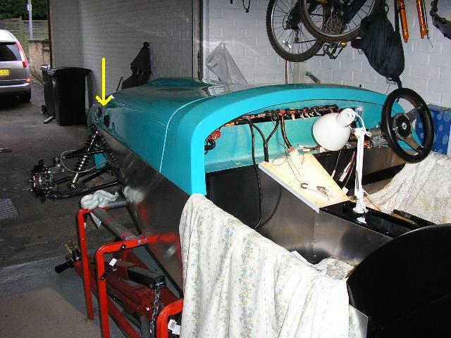

posted on 4/12/05 at 05:18 PM Reply With Quote

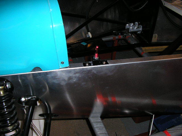

Paul (Notts)
posted on 4/12/05 at 05:19 PM Reply With Quote

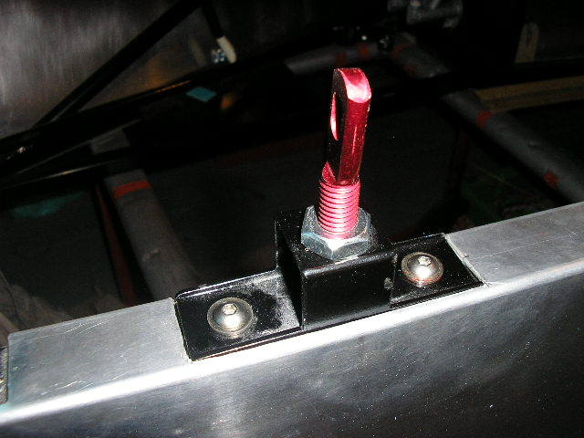

Paul (Notts)
posted on 4/12/05 at 05:20 PM Reply With Quote
wilkingj
posted on 4/12/05 at 06:07 PM Reply With Quote
Paul...
Many thanks for the piccies.. It explains it all now..I like them.. dont like the price but they make a superb job, and look the B's Knees..

Paul,
I have unashamedly copied you and bought a set of aerocatches for my Velocity. I was going to have a go at fitting them today and wanted to ask you why you made the fixing brackets rather than drilling through the chassis tube and clamping the pin to that?
Paul (Notts)
posted on 19/2/06 at 08:52 AM Reply With Quote
http://www.locostbuilders.co.uk/viewthread.php?tid=33425
was conerned about the strength issues by drilling through the top rails
take your time and get the position correct - my catches could have been better if i had fitted them 1 0r 2 cm lower as the back ones have to have the pin at a slight angle now due to the slope of the bonnet
Paul (Notts)
posted on 19/2/06 at 08:55 AM Reply With Quote
I fitted the brackets with two m5 rivnuts which allowed me to slide the brackects backwards or forwards by 2mm to get perfect fit

Paul,
The thread attached earlier put me off drilling all the way through the chassis rail so I bought a section of 20mm aluminium square tube from B&Q for a few quid and used it in a similar way as you did. It worked really well because the lower nut fitted perfectly into the tube which made adjustment very manageable. You can just see one of the brackets to the left of the throttle pedal. Rescued attachment DSCF0025.JPG
Paul (Notts)
posted on 2/3/06 at 09:12 PM Reply With Quote
looking good..
You may need to play around with the angle the pin ends up at..I ended up using some rubber tap washers cut at 5 deg. ( proto type) one on top and one inside the bracket to get the pin sloping inwards on the rear catches. The front ones were perfect straight up..
Steve Lovelock
posted on 3/3/06 at 09:55 AM Reply With Quote
You have more finesse than me, I too had to adjust the angle, I used a hammer!
