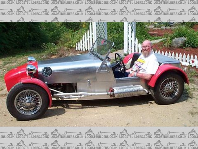

I liked Kens attitude. Nice guy. Sent me a really really nice mail once when I was in an argument on tol. It was something like, and these are my words....
Dont matter what others say. Lots of time in my life I have had people criticise and do me down, but ignore them. I always get my own back by tossing the bastards into the ditch as I blow them away on the track.
jonti
posted on 28/3/03 at 07:04 PM Reply With Quote
Well I don't think it would bend ..not even with me it !
An' if mine looks half as nice as Ken's when its finished (If it ever is !) I'll be a happy bunny
[Edited on 28/3/03 by jonti]
