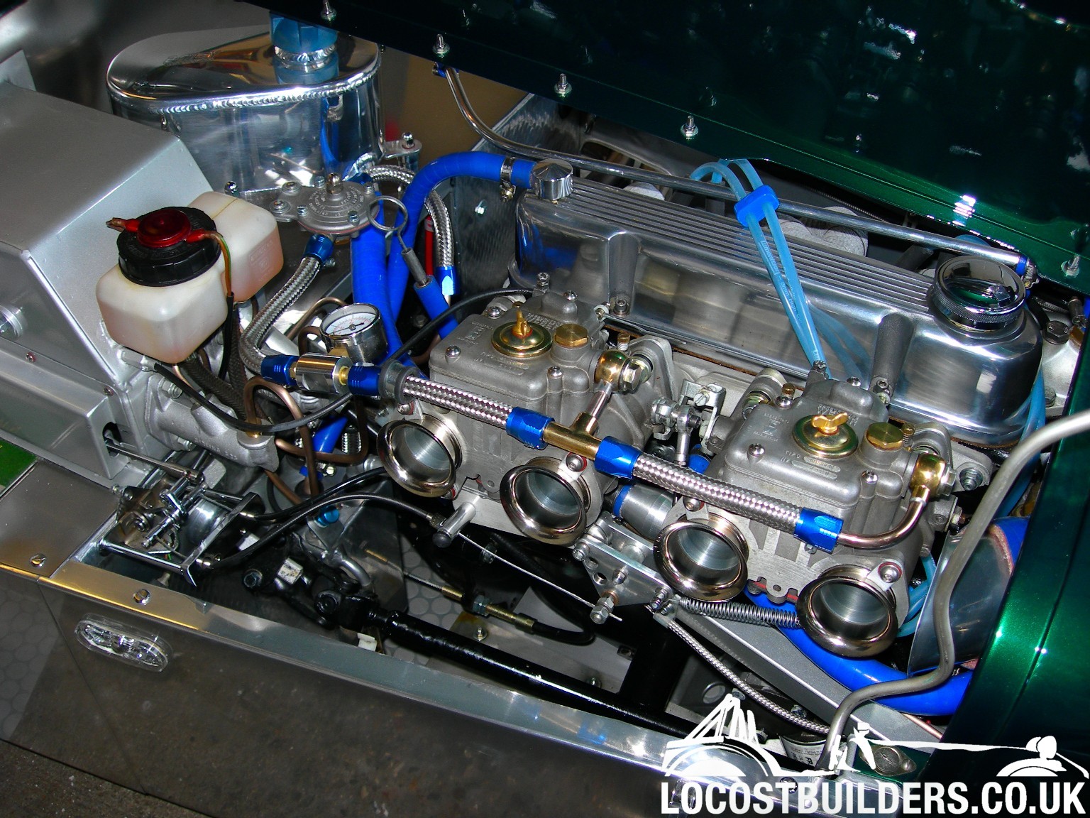

Fozzie
posted on 5/7/07 at 03:35 PM |
Twin 40's (Weber) on mine 1300 crossflow......
I admit they are not the most fuel efficient...but, I am happy with them!
Fozzie
http://www.locostbuilders.co.uk/upload/Fozzmobile4788.JPG
[Edited on 5-7-07 by Fozzie]
