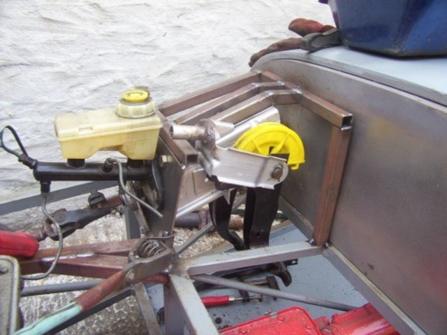

Mark Allanson
| posted on 7/11/03 at 09:43 PM |
Any good?
Northy
| posted on 7/11/03 at 09:45 PM |
F*ck me! Is it going to be strong enough?
[Edited on 7/11/03 by Northy]

PaulBuz
| posted on 8/11/03 at 04:11 PM |
Mark, bang on just what i was looking for, & as northy so eliquently put it, it ain't gonna fall to bits in a hurry
Simon
I hear what u r saying about level in reservoir, its just, will mr SVA agree with u???!
Paul

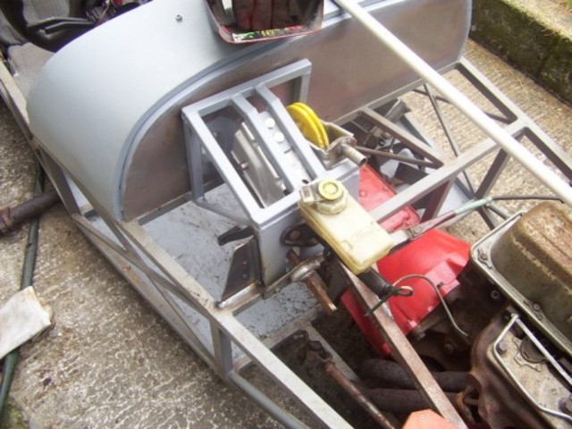

Mark Allanson
| posted on 8/11/03 at 04:49 PM |
Another shot, from above
